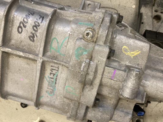

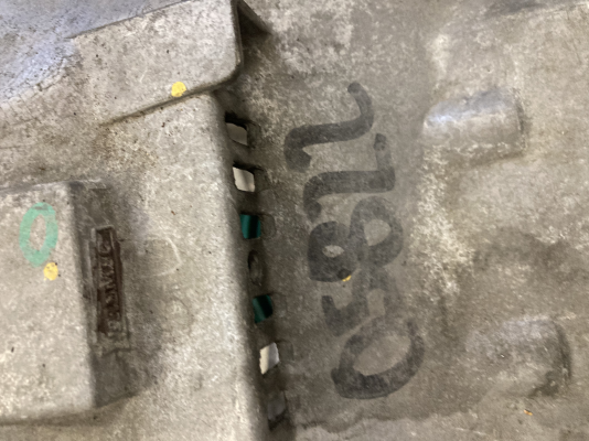

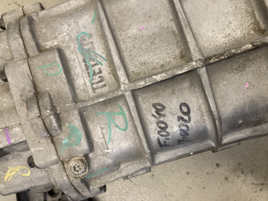

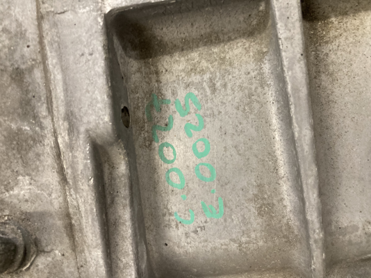

Beside the clutch story... found some "autogram stuff " on my tranny. Never saw something similar on a transmission before..
good or bad ??
Juice
Aug 24, 2017
5,059
2,169
Close enough.
That spacing will NOT change the engagement point. To change that, you would need to change piston bore diameter.
Juice
Aug 24, 2017
5,059
2,169
On the trans markings, the colored marks are factory. The black marker stuff looks like service "logs" by po.
