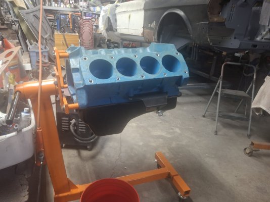

rraceme
Jun 15, 2026
20
8
AL
rraceme
Jun 15, 2026
20
8
AL
An older fella here has a '10 that he put a 427FE into, so, it's possible. Real professional work. He's from Detroit, where the work was done.
Thank you kazman. I don't give up on projects. I pulled out my composite sbf block. Put rear sump oil pan on and solid motor mounts. After church sunday will start fabrication on rest of mount to bridge old w new. I will load pics in future.
