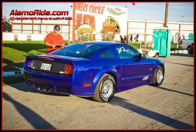

heres a photo of my saleen on bogart D-10s, purchased from sjm manufacturing , no grinding only had to remove the rear swaybar . I sold the bogarts but does anyone know if the billet specialties wheels will fit ?
