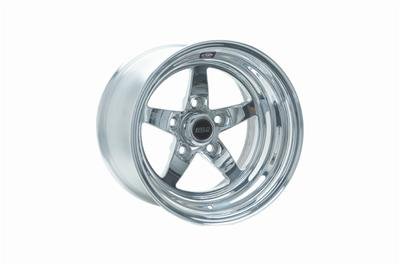

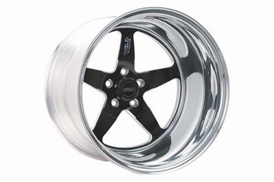

Looks like there is another 15" wheel option. Weld racing has RT/S wheels. All polished or with black centers.
  • Weld Racing RT-S Wheels.pdf
