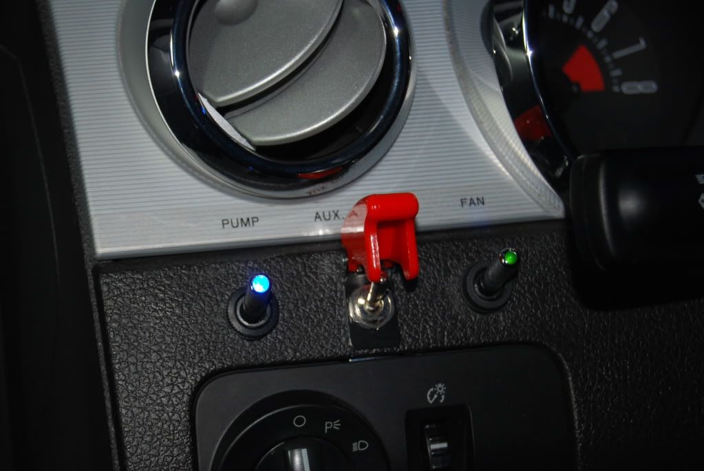

I have a 180* T-stat and Meziere electric. My temp gauge has never gone up to the halfway point where it used to sit when stock. It is always 1 notch below that. In fact I've seen my gauge go down as I sit idling in the staging lanes.
The nice thing about an electric is it is flowing full force when there is no air flowing and will help keep it cooler when you need it the most.

And we could have seen a decrease in cylinder head temps with just the lower thermostat, but I know the dropping of temp in the staging lanes has got to be from the increased flow at idle. Wish I would have done some empirical data testing but it has always been my experience that electric pumps have kept my motors cooler overall than mechanical ones.
And yes I have run the pumps (intercooler too) in conjunction with the high speed fans when hot lapping at the track. Seems like I can do a run about every 15-20 minutes without any heat soak issues. You do need a jump box handy, just in case.

And so you wouldn't put on in a daily? I'm a firm believer that it just benefits to have more water flowing all the time. I know some folks will mention reliability but I've had both mechanical and electric pumps fail on me. More mechanical because I had more cars with them vs electric. I go through more belts (Whipple) than anything and if I had to, I could probably drive my car 25-40 miles on the battery if I snapped a belt and not have to worry about overheating. I kinda think it's one of the best simple mods to do for a daily or track car, but that's just me.
And I really wouldn't get stuck with a bad belt. I always have a spare and a small pry bar in the trunk.
