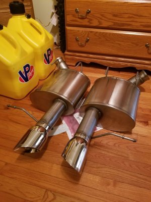

Now that my car is FI, my outlaw axelbacks are WAY too loud. I was considering either the GT500 axelbacks or the Corsa sport axelbacks. I was told by Evolution Performance that the GT500 mufflers will eventually blow out, and to get the Corsa's.
I see they sell the Corsa Sport for the GT and a different Corsa Sport muffler for the GT500. What is the difference between the two? I have a GT that is making GT500 power and I'm not sure which model I would need.

Unless your looking at single tip versus quad tip they are the same muffler. Both will bolt up to your car. Just one will be a single tip exhaust that will fit your bumper or the quad tip muffler that fits the GT500 rear valance. I have Corsa Extreme GT Specific Quad Tips on mine. Hypermotive sells them. I had to trim my rear valance to clear the tips but future plans are to put the 13-14 rear bumper on it and use the GT500 rear valance to make it look correct.

The Corsa Sport for the GT is 14316. The Corsa Sport for the GT500 is 14320. The GT500's look larger and are more expensive. I don't know what the other differences might be.

Yea I'm not sure. I guess I should find out before I order.
JG-1
Mar 2, 2016
512
53
Hainesport, NJ
Ok, I found this...
"The Corsa Sport Axle-Back Exhaust, for the 11-12 gt500 features 3 inch tubing. However the GT features 2.75 inch tubing."
So do I want the GT version? I'm running Kooks 1 7/8" long tubes, kooks offroad H, Lethal perf Gen 2 over the axle pipes.

Well, I needed more than a muffler change. With the Corsa Sports on the car was still WAY too loud. Evolution Performance said put the OEM over the axle pipes back in with the resonators. Huge difference. Sounds great now. The Lethal Performance OTA pipes caused a very loud rasp.
