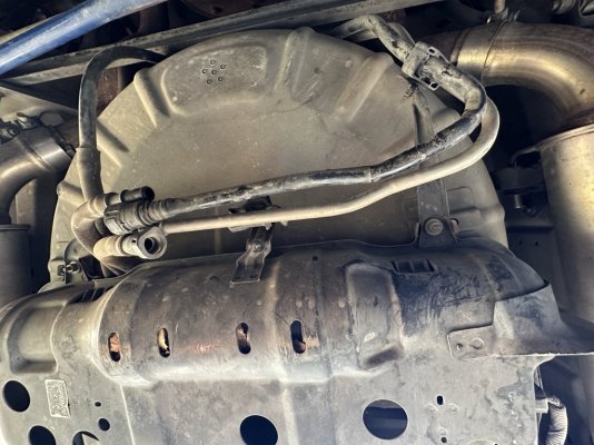

Made some progress via the EVAP canister out back. Found a little electrical tape repair from the PO. This is the hard plastic line (not the metal line) of the two that come off the canister assembly (also NOT the vent tube). I looked up and it goes to some sensor, then onto a nipple on the passenger side of the fuel tank. Pressure relief? Soo. With this “leak” / hole of sorts. It can’t build pressure? Opposite of my issue or maybe the canister can’t suck it out. Idk. Gonna go to the boneyard and get an entire hose and see. Check pics. Again, no CEL which is shocking. IMG_3742.jpeg
