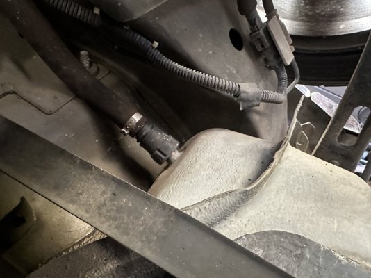

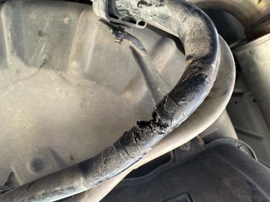

FIXED. It was leaky freaking injectors. Tossed em in and it starts at any temp after any amount of driving. Freaking finally.
I did also replace the evap line and blew out the canister (unrelated) but will fill up the tank and see if THAT issue is fixed.
