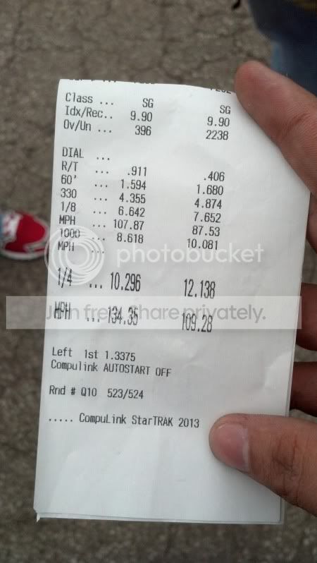

On September 27, 2013 we had a S197FORUM meet where we went out and definitely had a good showing against the SUPER CHEVY guys out at ROYAL PURPLE RACEWAY. On that night I went out on a 3.6" pulley on the brand new tires that I just mounted that day. This was going to be my first 1/4 mile passes since getting tuned and I was hoping to go 10.9x but was REALLY hoping for a 10.75 as a best. I went 10.69 on my FIRST pass before a cool down even.
My best pass that evening was as follows:
This was backed with SEVERAL 10.6 passes throughout the day
The DA that pass was around 1800 so I was really excited to run such a great number especially after seeing the huge dyno numbers that the E85 paxton cars were throwing down. I made a lot less power but was able to run the number with them ;)

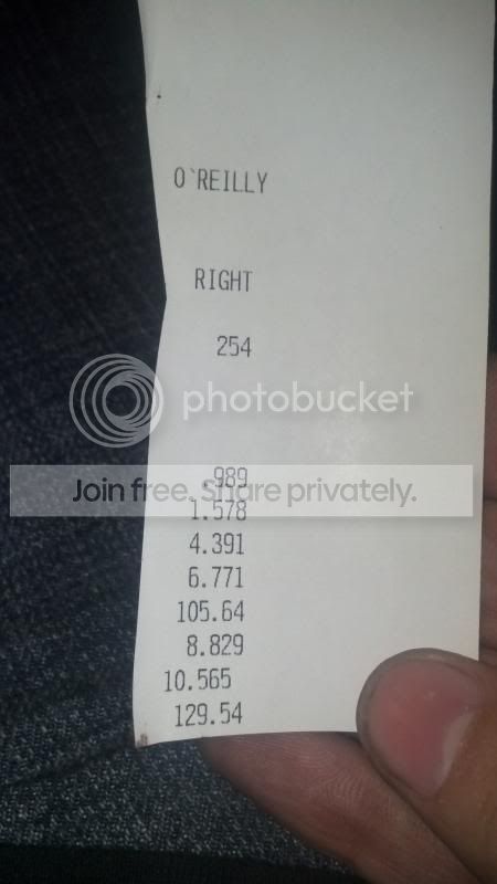

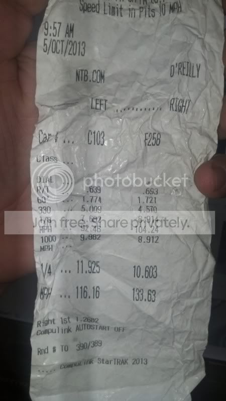

After a horrible time trying to get my car off the trailer (kept bottoming out), I made 2 passes during some time trials. I didn't want to do burnouts even as I hadn't even got the car in boost since the pulley swap so I wanted to datalog a run first. The first real lazy pass resulted in:
and then I knew then with the extra MPH that I was going to be fine when I actually made an all out pass.

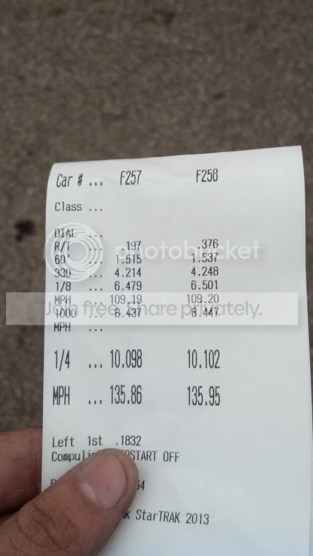

During my two qualifying runs I actually launched the car and let it eat. Here are those two runs:
The 1.51 60' is the best that my car has ever seen. This was done by flashing the converter from a low rpm. I, yet again, exceeded my goal with these two runs and with even better air coming in I knew it had potential to get good later on.
So after sitting in Billys (05stroker) car trailer for a while Larry decided to call me out with GRN13 which all of you should know about that car. I believe he even mentioned that he didn't even need a helmet while racing against my silver piece of shit haha
GRN13 was car 257, I was car 258 so you can see by the results that the driver mod resulted in him getting the win; it was a close race though and I didn't mind at all being the victim of some Ford vs Ford crime in this case.
