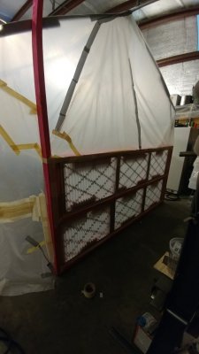

Yeah that's a "hoop house" covered in plastic. I built that inlet filter box.
Here's the exhaust fan box. Scavenged from an old hvac handler.
I looked up how to make a transition fitting out of sheet metal. Not too shabby if I say so myself.

Got the exhaust box finished. I don't think I've got enough cfm. I have a fresh air supply I can wear but I'm afraid if this doesn't evacuate well enough I won't be able to see.

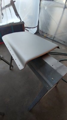

That's actually the ONE thing I have that's right. My air supply is our big air compressor from when this place was the main office for our drilling business. I bought the property after my father died. I've ran out of the first tank into another 80 gallon tank with an orifice that causes a good pressure drop which precipitates moisture and then out of that tank with an inch and a half vertical drip leg. Then another drip leg before it goes into a separator, then into a large desiccant drier. Then thru my second regulator into the booth. I've got another desiccant filter and regulator at the gun. What do you think? It should be good. I'm about to go in and try doing the scoop first. (Off the hood) Wish me luck!!!
MrBhp
Sep 12, 2013
1,840
1,529
I masked off half the front bumper cover last night. The right side of it had slight damage. This is really an experiment to see how well I can blend into the other side. Also, the stripes on the front cover were painted, poorly, by the local Ford dealership. I wanted to see what happens when I lay clear over single stage paint. I painted the black this morning, this is the video of the clear. My pressure is a bit too high, going to take out about 3 psi. I have the original cover that came off the car before this one replaced it. I'll be repairing and painting the original once I get my sea legs.
