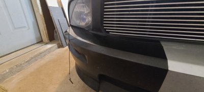

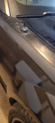

Here's the (hopefully not final) outcome to my foray into the autobody/paint business.
The following is a quote from two years ago when this thread was active.
My previous post brings up a good point. I can apparently get the product on the panel to my satisfaction. Which in itself is really surprising to me. However, I really don't know the technical side. I have to rely on the recommendations of others to know what products to use in a particular situation. That's something I hope to learn with experience.
Turned out to be somewhat prophetic. LOL Check out the following pictures.
So, here's "the rest of the story". (Thanks Paul)
The last night I painted was when I did the driver side door, passenger side fender, and half the front bumper. I was painting to about 1AM. That's when the wind is at it's lowest and even though I'm in a filtered air booth, I still will take every advantage I can get. After I finish a spray session, my habit is to step outside the side door of the shop where I have a wood palette leaning up against a stack of wood. That's where I clean my gun and hang it there overnight. After my paint session that night I walked up to the house, took a shower, and turned in. I woke up around 5am to the thought that I did not clean the gun. I figured it was ruined by now since the last thing that went through it was clear. I got up anyway and went out to the shop. I picked up the gun, went in the shop, and to my absolute horror saw about a quarter inch of clear in the cup. My horror was increased when I realized the clear had not set up. It was still as liquid as it was hours earlier. As a matter of fact I was able to clean the gun just fine. But...... if the clear in the gun didn't harden, what about the clear on the car???? It looked great, but didn't seem right. I pulled the car into the sun to look it over and bake a bit. I recalled having a bit of a sag right above the door handle. Not quite a run. I got a new razer blade to cut it out and that's when the heartbreak began. The sag was still soft. Couldn't even cut it. I could push a fingernail in the clear, all over. I called the paint store. He asked what hardener I used and I told him it was the one he sold me just yesterday. After looking at his records he says, "Oh no, you bought additive for the base coat, not clear. They are completely different things". I said no, YOU SOLD ME ADDITIVE FOR BASE, NOT CLEAR".
He said it would eventually harden in the sun so it sat outside for a week and got a bit harder, but crinkled a bit. I let it sit another week then hit it with 600 grit and brought it to a beautiful finish with lots of machine polishing work. Then it crinkled again in about a month, so I cut it again. And it crinkled again. By this time I had cut through the clear in several places. (And I had moved to Oregon.) The clear was never going to be right. Clear uses chemical reaction to harden. No amount of air, heat, or sun will work. By the time I got back to Texas my paint booth had been disassemble and I was dealing with cancer, again. So it still has the crappy paint on it. Poor car. But the hood still looks amazing! And the other front bumper looks great as well. It is sitting wrapped up in a blanket upstairs in the shop. And me and my car are in Connecticut for cancer treatment, again. F' me.
So for you few guys who wanted me to paint your car, aren't you glad you didn't?
