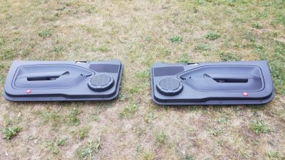

After fixing mine a couple of times, I ended up going with Coverlay ABS inserts. You don't need to, but I removed all of the material from the door, right down the plastic before gluing the new inserts. In my opinion, doing this made them fit better. I took the panels off of the car so I could place weight on the inserts after gluing. I am really happy with them, and hopefully, I will never have to fix them again. 20200614_103533_resized_1.jpg 20200614_124027_resized_1.jpg
