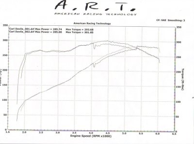

Hey guys i had a dyno on saturday with the new mods, Bassani catted x-pipe mac axle back, and a C&L Racer witha Bamachips 93 octane race tune here is a pic oc the dyno sheet, does it look ok to you guys i was a little worried about ths dips closer to the end of the runs.02-02-2009 06;11;34PM.jpg

damn! 285 at the wheels?? i would have expected at least 290 or better. im in the process of doing the same mods ( o/r x pipe instead of catted and i was going to do a jlt cai). i think you catted x pipe might be hurting alittle bit but im not sure

Thats what i was thinking, it sounded like a lot more, i was wondering because another 05 was there and was only 2 hp an 2 tq behind me and all he had was a JLT and Brenspeed tune.

You might want to get a dyno tune, it helped even things out on mine.

yours says 315 at the wheels so your either on an extreme tune or you have alot more mods then what im looking for

I got with Doug at Bama and he said the numbers look about right but that i might have gone lean at 4100 but i think he is going to send me another tune then i will go get another dyno and make sure they do the a/f this time.

Since it says HPP Motorsports in big black letters across the top of the dyno sheet, I would guess at HPP Motorsports.... just a hunch.
+1111
That sheet is deceiving. It is STD not SAE. Depending on the weather the day he did it, that could make quite a difference.

I dyno'd 287hp and 299tq with just ford racing shorty headers, xpipe w/ highflow cats, magnapacks mufflers on a Mustang Dyno.
From what i know a Mustang dyno is more accurate just cause they apply the weight of your car to the belt driven rollers your pulling vs other dyno's your just pulling the rollers that weigh an "x" amount and your dyno results can be off up to 30hp to true HP numbers.

Well i just got a new tune from Doug at Bama plus i just got a race tune from Tillman, and i will try them tomorrow.
