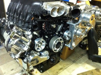

Got news today the engine was done.
Engine specs...
Bored .20 over with diamond pistons with ring lands moved down, stainless rings, new I beam rods. 3.8 stroke with all new bearings and all ARP studs

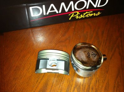

New piston on the left. These are hard anodized coated to help dissipate some heat....
Crank has been double keyed for the ATI damper. This will help with the torque of the F1A to be installed.
The other new upgrades are BMR LCA AND K Memeber. New injectors but haven't decided on the 80lb or the IDE100.... Still researching this.

What was the old piston? What happened? I've heard nothing but great things about the ID injectors compared to the 80's. I don't have any issues with my 80's.

Cp pistons were the old pistons. Standard bore with 19 cc making it 9:08 to 1 compression. The piston gave out from a lean condition maybe. Not to sure ..... Frustrating for sure...

Will post pics of the motor before it goes in the car
