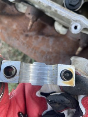

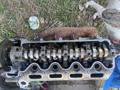

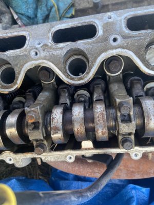

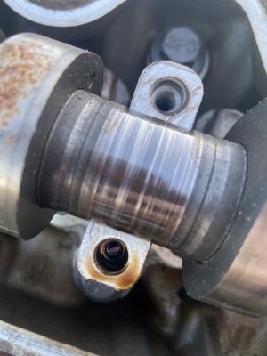

I’ll have to wait for a Amazon borescope to come in to look inside the engine but I’m afraid this tells me all I need to know.. Cam journals show some serious grooves and the cams even got surface rust on it.
Also I was gifted with a broken spark plug This is looking like a ‘down to block’ rebuild isn’t it?

Unfortunately the heads and cams are junk so you might as well pull the heads off. If the pistons & cylinder walls look OK, the short block might at least still be salvageable. You might want to pull the oil pan to check if all is well at the bottom end.

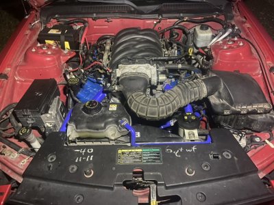

Hey! I don't know if anyone remembers this post and... Holy crap has it really been that long??!? Sorry to take so long but hey, such is life. Long story short is I HAVE A MUSTANG AGAIN! and I thought I'd come back and update you guys in case anyone else is trying to decide what to do with their blown-up car, or just in case anyone was curious how it turned out!
I ended up buying the re-man'd engine (instead of trying to rebuild) for a lot of reasons but mostly it was to make the job easier :shrug: I have minimal mechanic experience, but more importantly I didn't have a garage to do any of the work in so everything had to be done in my drive way! I still want to rebuild an engine some day but hopefully it'll be on a different project lol.
Even adding in all the random tools and such along the way, as well as Pypes Short tube headers, under drive pulleys, Exdedy Mach 400 clutch, and BMR poly motor mounts, I was still well under the $7500 I was quoted by a local shop to drop in a sealed,150k mile, junkyard engine PLUS im up all the experience and knowledge I've gained doing the swap :D I'm sure the whole thing could've been done cheaper and faster (It passed inspection and was licensed in early February, for a timeline) but neither of those things were my goal. My goal was to get the car back on the road and, for now, I accomplished it!
