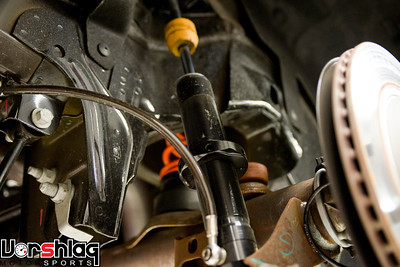

We haven't done any front LCA or front bushing mods on this car...

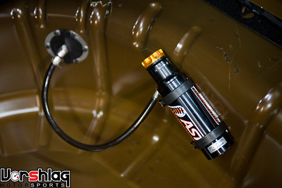

But we did add some high end double adjustable AST coilovers with remotes, stiffer springs, a bigger front swaybar, WL rear LCA brackets, and WL adjustable panhard bar, along with 18x10" wheels and 295mm Nitto NT-005 tires to this car. Not a peep from the EPAS.
And we've tracked it 3 times, without issue. But again - we never touched the LCA bushings, which seemed to be the trigger on our red 2011 GT.
