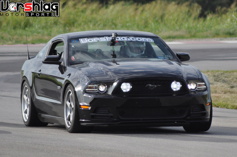

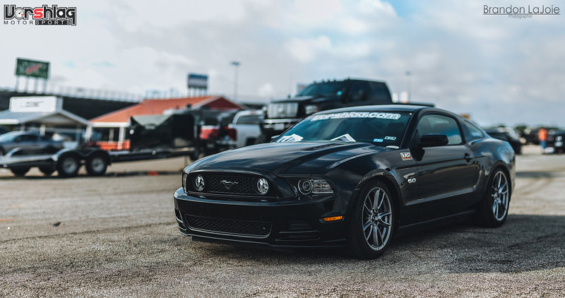

We didn't have any problems on our 2013 GT (above) with AST remote reservoir coilovers, lots of negative camber, big bars, aftermarket PHB and Whiteline rear relocation brackets, using 18x10" wheels and 295/35/18 tires at all four corners. Street, track or autocross.
But.... we never changed the front LCA bushings. That seems to be the threshold that cannot be crossed if you want to avoid EPAS issues.
