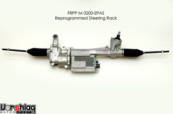

The M-3200-EPAS rack is finally back in stock. This is merely a stock 2011-up rack reprogrammed by Ford Racing to turn off all of the loopy programming.
This single swap will fix any and all steering shudder caused poor electronics programming and/or major suspension mods.
Works perfectly on the street, autocross or track. Took one of the largest (and only) complaints I had with this chassis and completely removed the issue. I was 100% satisfied.
Back in stock where and for how much. Thankfully, I think I'm ok for now, but I have more suspension mods planned and want to have this info if I need it.

Any FRPP dealer can get it, and I think retail price is $1299 and street price is closer to $999. Do a search on that part number and you can see. :)
Most dealers won't stock it - it will likely ship right from Ford Racing, as I believe them program/build them to order? Got ours 3 days after it came off backorder, just in the nick of time!

So, Terry, are you aware of the possibility of the stock racks being reprogrammed with the same FRPP-M3200-EPA program?
I have a guy (customer) working on a very cheap solution, but it would be more along the lines of "rigging".
While trying to find a solution to the issue for Terry I've spoken to the actual Ford engineer that does this and they refuse to reprogram used racks and will only sell the programming with a new rack. I don't know if it's because the ECU cannot be re-flashed once it's been programmed, or other issues. But I doubt it's strictly because of commerce. They were very sympathetic every time I called and tried to find other workarounds.
If someone has an inexpensive aftermarket solution I'd like to hear about it.
