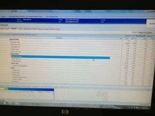

Yes I have the estimate.
Yes I have the check.

I mean we write for Allstate and State Farm and some of the small companies as well, our labor rate is only 44 dollars an hr for body and paint with 30 dollars per hr on paint materials.
One photo is blurry the other you can see the total amouny
