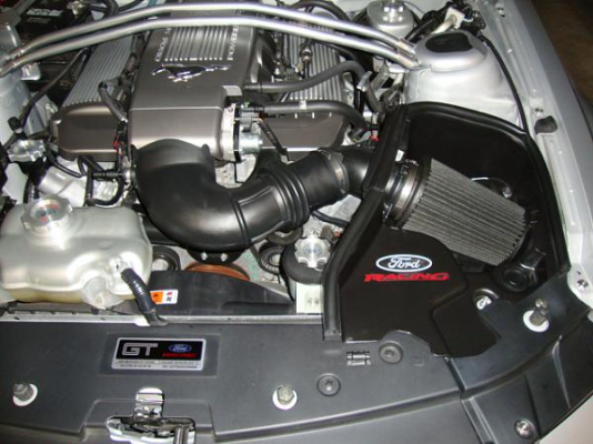

AFAIK, this is the CAI you could buy via Ford Racing, the original Bullitt (which I bought) had 2 additional resonators attached below and the Ford logo not painted. The Bullitt had also a special hood insulator to seal the box to the hood.Here is a picture of the intake. Kind of confusing because it is different than the FRPP or Steda but still says Ford Racing on it.
The tuner should remap the MAF sensor transfer curve to compensate for a larger diameter intake pipe, thus ensuring that the commanded air:fuel ratio remains correct.AFAIK, this is the CAI you could buy via Ford Racing, the original Bullitt (which I bought) had 2 additional resonators attached below and the Ford logo not painted. The Bullitt had also a special hood insulator to seal the box to the hood.

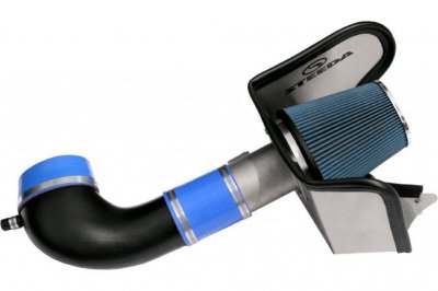

BTW, everything you said above is spot on, and the Ford Racing intake used in the Shelby GT is exactly the same as the Steeda CAI except for the Ford logo.
