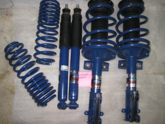

I have a Ford Racing strut/shock setup with springs designed for the GT500. I had it on my car for about 3-4 weeks and removed it. Very stiff, but if you want a Ford Racing setup you can have it for shipping costs. Been taking up shelf space for 10 years. Google M-18000-C. IMG_2848.JPG

You cannot go wrong with a good set of quality struts and shocks (i.e., Bilstein, Tokicos, Ford Racing, Yellow Koni, etc.) Don't forget to upgrade with GT500 upper strut mounts, bump stops and some camber bolts (depends on alignment specs).
Personally, I currently have those same Ford Racing Struts (listed above) with GT500 track-pack rear Bilstein's & Ford Racing "P" springs (1" drop) on my 05" GT, car handles like it's on rails but stiff... I also have F/R big sway bars and all sorts of braces.
FYI I had F/R Tokiko's on my old 06' GT Convertible with adjustable on the rear with GT500 springs. Loved the way they rode and handled very well.

That's the best you can do, unfortunately. I had mine for sale for I think three years. I kept lowering the price until I finally gave it away at a tag sale. Seems everyone wants the shiny stuff. I do wish I had that kind of money in my younger days. Hell, I don't have that kind of money now.

I have a Ford Racing strut/shock setup with springs designed for the GT500. I had it on my car for about 3-4 weeks and removed it. Very stiff, but if you want a Ford Racing setup you can have it for shipping costs. Been taking up shelf space for 10 years. Google M-18000-C. View attachment 117347
Do you have the part number on the springs?
