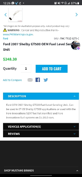

    Hey guys I'm going with a fore l2 return fuel system. I'm using the dual pump version with TI F90000267 pumps, and staged controller and Honeywell pressure switch. Fore mentions that for 07-10, they require the gt500 level sender. Doesn't state what part number, etc ..Can't find info on here, or any other forums. I've looked for installs that were completed and no one mentioned the gt500 level sender. Can anyone shed some light here?

    You can use either a 05/06 Gt metal body sender (not sold so would need an original) or buy a 07-09 gt500 sender. That price is a rip off for the gt500 sender you can get them cheaper from a ford parts dealer they retail for $170-180. The ford part number is 7R3Z-9A299-A. Or when I spec and sell Fore kits I offer new senders pre installed and tested for $100.

    Yep I didn't know this I messed up :(
