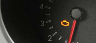

Hi,
I have a 2006 Mustnag GT. 37K miles. Runs ok. Recently i have seen the engine light on so i have read on this forum and it is a great one, that i should unplug the battery for couple of seconds and the engine light will disappear and this exactly what happened. After this, i have filled the car with gas and the needle of the gas is showing exactly what it is supposed to but the digital trip keeps on increasing while driving and it never went down as i consume the gas.
I have an OBDII and tried to fix the issue but it shows that all ok.
So guys what seems to be the problem?
Thanks for your advice and help.

I am having the engine sign from time to time that keeps coming back. I am canceling it by using the OBDII, but the question is why keeps on coming back? The car runs great. Oil is ok etc..
