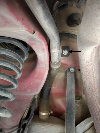

My tank fills quickly until it's half full. Then the pump keeps clicking and it becomes a frustrating exercise to fill the other half. I remember when I lived in the UAE that I had no problem filling the tank right up at any gas station in every Emirate except for Dubai. Here in Cyprus I have the same problem that I had in Dubai i.e. slow filling of the second half of the tank.
What I've found is the following:
1. Turning the nozzle in any direction doesn't make the slightest bit of difference.
2. My fuel tank vent line and my evap system (including the charcoal canister) are free of any obstructions. I can blow compressed air through them and it comes out the other end no problem.
3.

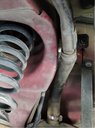

The filler pipe starts in the filler cap goes downwards under a longitudinal beam, and then a little upwards over the rear axle, then angle down and drop into the tank
THIS is the fundamental problem! I believe air gets trapped in the highest part of the filler neck that curves around the spring perch when the driver's side of the tank is full because it simply has nowhere to go.
Ford only fixed the problem on models built from May 2008 onwards when they added an integral vent tube to the filler neck. I don't know if it can be retrofitted to earlier models like mine though.

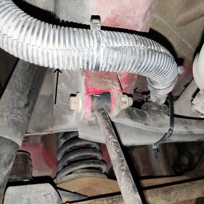

I did come up with a partial remedy though by simply adding a 1" spacer underneath that black mounting bracket in the center of the photo and used a 1" longer bolt. This lowered that highest part of the filler neck just enough to make the fuel filler nozzle click less frequently once the tank is past half full.
Keep in mind that this IS only a band aid. The fuel filler neck itself also needs to be cut above the point marked by the arrow in the picture below and shortened so that the section further down at the zip tie to the right of the arrow can sit higher and tighter to the frame rail. This will make that section level with the section that curves around the spring perch and might just solve the fuel filling problem altogether.

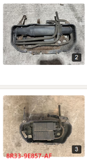

I can fill up the tank on full open nozzle speed when it was below 1/4 full. If it is above 1/4 it stops at half a tank and above 1/2 it is very slow and can throw up fuel. No solution, no explanation, beside that the filling pumps and nozzles in Germany have a integrated fume scavenger system and the European cars deliver the fumes back to the pump and not into the carbon canister.
They changed the EVAP part over the years, too. I have type no 2:

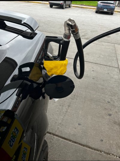

The problem was much more pronounced when I was burning gas. Once I switched to E85, it was less but still happened. The yellow handle indicates E85. Some stations have faster pumps than others. Which cause the issue.
I have 6 stations within a 5 mile radius of my house and this is the time of the year they change ethanol percentages. Lito has given me 3 tunes for 70%,75%,80%. 75% is the most common, so I have to sample who is pumping what and when. Or else I have to blend my own. I always keep around 10 gallons of 98% ethanol just in case. One time I stopped to fill up away from home and the E85 was in the low 50’s.

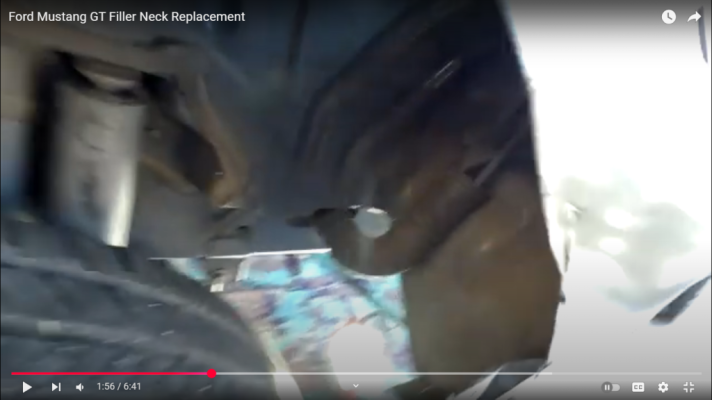

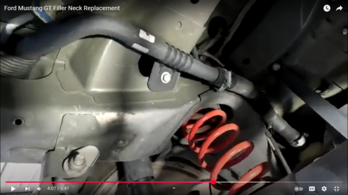

Here's a picture of the 11-14 Mustang fuel filler neck.
Notice how the filler neck goes through a hole in the top of the frame rail instead of going underneath it. That makes all the difference because the fuel doesn't have to go down, up, and then down again.
