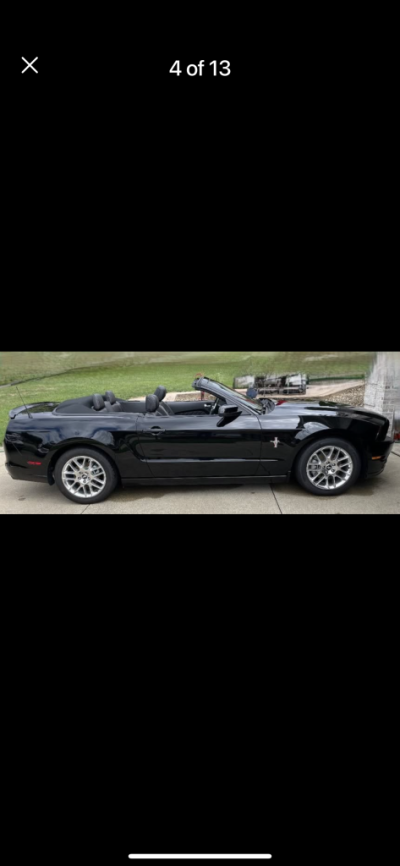

I am picking up a very low mile 2014 3.7 Convertible. Pony package bone stock.
