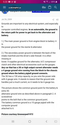

I did find this on the internet. I do believe the new alternator was a 3g upgrade Screenshot_20210412-052024_Firefox Focus.jpg

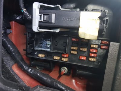

I installed new power and ground cables. Still didn't fix it. I was going through my fuseboxes and saw that some of SJB parts had corrosion on them. I am almost 100% sure it has to be this box. That would explain why I can get the turn back on after removing the ground cable for 5 mins or so after it completely dies. Power cable upgrade wasnt the issue tho

check for water intrusion, notorious issue with these cars, front cowl drains get clogged.

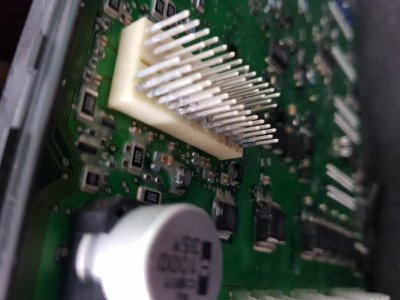

20210421_151248.jpg20210421_151243.jpg20210421_135455.jpgi cleaned all the contacts and made sure no more corrosion was left. It wasn't as much as expected but definitely was there. Fingers crossed this fixes it

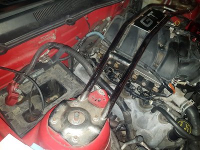

I added a 2 gauge power wire + dedicated ground incase of any power wire problems. 20210420_172609.jpg
