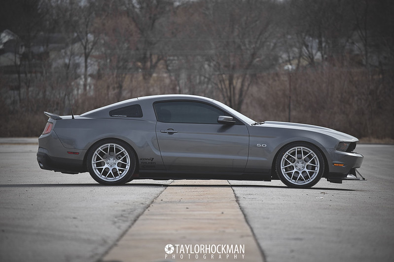

Yep. Per 14.2.F you are not technically legal for ST (it's not a production part but a performance catalog part). To me it looks fine for SP. That said, the LS splitter--which is legal due to being a standard part on the Boss 302 LS--is bigger. I wouldn't protest it, and if someone does, it's a dick move. Personally I'd just run it and if someone does pull the dick move, then cross that bridge then.
Not SP legal if it protrudes past bodywork or isn't a factory part
The way I understand the rule, "if it protrudes past the bodywork" would mean that the splitter protrudes past and leading edge of all body panels.
I cant tell from the pics if the splitter comes out part the center point of the bumper, and on the sides if it comes out past the top leading edges of the fenders.
