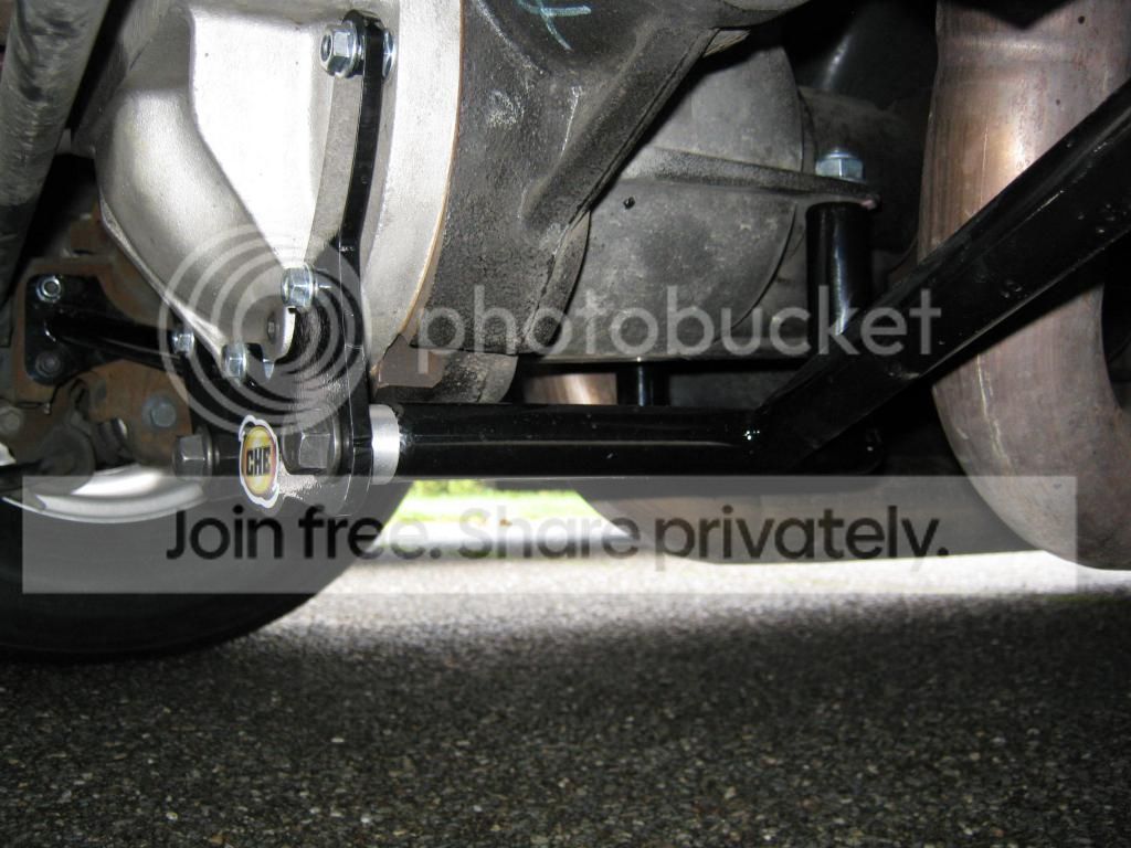

Just a follow up on the CHE brace I installed awhile back. It really helps with traction. I haven't been able to make it to the track but I have had to do a few pulls to fine tune my gasoline tune.
I'm not much of a suspension guy. I don't know why certain things do what they do so I can't really say what this is helping with. A guess would be flex and rebound is lessened. At any rate it's a worthwhile traction mod. Wish I knew why, lol.

No, he means the axle brace.
