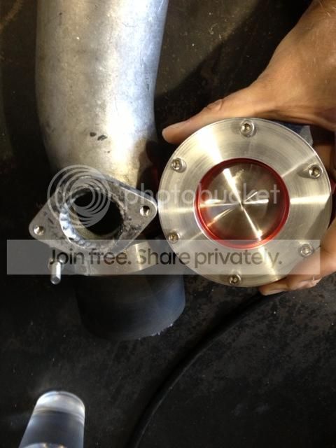

The valve that comes with the kit is too small. Fluttering is bad and you need a bigger valve. I replaced mine with TiAL valve and its been perfect ever since

i wouldnt say it would cause damage. Its just a little undersized for the amount or air the 2200 flows. once you crank up boost we have seen them push out the o ring causing a boost leak

If you have a BOSS or a Track Pack car, I HIGHLY doubt the Big Red valve will fit in there without custom pipes.
We are making the pipe to fit the 90 under the stock pipe with the BOV. i have it on a boss right now with all the track pack stuff so it will work no problem! We will have a block off for the stock BOV for guys with high boost

That makes sense. Paxton put the valve in a stupid ass spot. lol.
My Q valve barely fits in there lol
