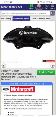

Can vouch, will put abs to the test for sure. (Just saying they can bite well). I would like to get the larger brake booster as I notice more pedal travel, but I never have pushed to the floor with out breaking the tires and abs kicking in. I bought these from rockauto. You need 2013-2104 gt500 rotors and aftermarket brake lines for 2013-2014 gt500. I went with stoptech's as braided lines and stoptech slotted rotors. Saving for the rear 2013-2014 rear gt500 caliper brackets, seals, rotors and pads to upgrade the rear too.
...and yes, wheel clearance must be considered. Stock 2014 and older ain't gonna cut it without spacers. However the pp rims should. Dunno. You would think so since this is the caliper behind them stock.

Agreed, but when you got them were they legit? I would imagine they were being motorcraft parts Lol.

As best I could tell. They had original boxes, nothing resealed, labels with all Ford info was fresh, and they look amazing. I was so convinced I never sweated it. I seem to remember seeing fomoco on them, but now that I have got everyone's attention I am second guessing.. lol I will have to pull a wheel tomorrow to check. Lol.

For sure. After I bought the 18 i loved the pp brakes so much I started looking to swap them onto the s197 and saw them on rock a, but the same thought crossed my mind except that they are listed under motorcraft. They look sharp as hell Black to boot. Thanks for the input!

The motorcraft 6 pots are legit, RockAuto wouldn't put Chinese bootlegs in a motorcraft box.
