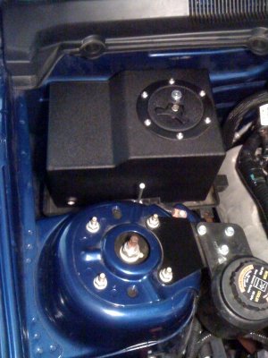

I guess using a GT500 IC tank in it's stock location or using a Moroso tank and sitting it off of the passengers shock tower doesn't count since everyone seems so quick to convince you to relocate your battery. So I won't bother to mention the multiple times this same thing has been asked and I have posted pictures.

Oh i've seen your pics of the GT500 tank, but I don't want to hack up my intake, though I haven't seen the Moroso tank on the other side.

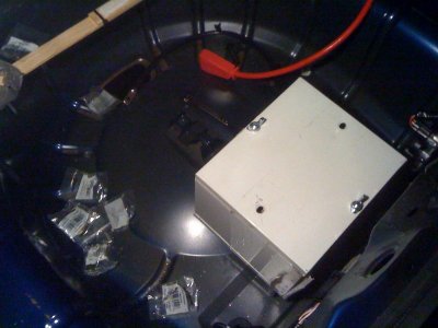

Silly question, but when you guys relocated the battery to the trunk, did you just run the (+) power thru the cabin?
Hawgman, did you have to modify anything in particular to use that Gt500 tank or the Moroso strut tower tank?
I ran a 0 gauge wire from the front of the car through the cabin to the trunk area.
I've included a couple of pictures of my setup for reference. The battery box was only partly done at this point. I'm not a fan of this box I choose so I'll be switching to this box. It's smooth on top and will allow my trunk mat to sit completely flat once I modify the box.

One of the biggest problems is every tank I find only shows on angle and you can't see the mounting hardware.
