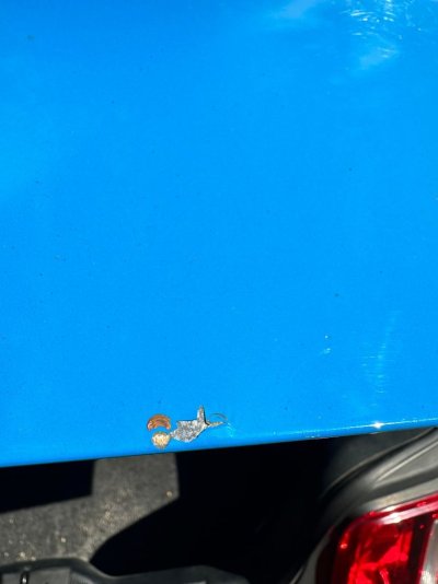

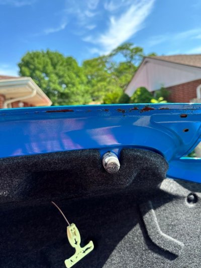

Just joined. Also a member of Mustang6G. Looking at a 2012 GT Premium for my boy this week. Aside from all the typical things one needs to look at when gambling on a used vehicle, is there anything in particular to look out for on this model or S197's in general? The only concerns I am aware of is some paint chipping at the front edge of the hood and a little on the rear trunk lid, that looks like starting to see some surface rust on the under side at the rolled edge, and a worn steering wheel. It might also have some outstanding airbag recalls needing to be done, not positive, just maybe there is good reason someone would avoid having this recall work performed?

Paint chips are pretty easy to manage. Rust is probably going to be somewhere here and there if it was not garage kept there in Missouri. I'm from Indiana originally so I know all about the midwest winters and salt all over the roads.
Your primary concerns should just be mechanical soundness. The only way to check that out is to ask to have the car taken to a shop for an inspection and offer to pay for it or see if they will let you take it yourself.

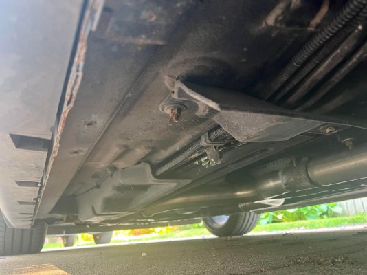

There is a really nice one just like it with all the exterior cosmetic options, including white stripe, always garaged, 78k mi., but owner lived on gravel road and bottom side is either caked with that or a little too salt exposed for my liking, and they are 1-2k higher than I'd like right now. It also looked like the axle housing showed signs of seeping from the diff., but maybe this is typical.

I would pass on that car. If the decklid is that badly rusted, the undercar has got to be at least as bad. Maybe look for a southern car. Damn shame somebody let that car rust like that.

Thanks, that's what I was thinking, but the underside is remarkable. Carfax shows it got undercoating at the dealership at time of original sale. Working on a 2014 w/ 76k mi. but it has been diddled a little.
