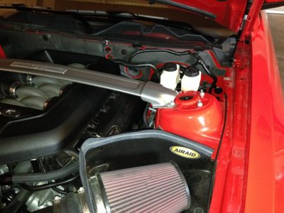

I bought a 14 TrkPak with 2100 miles back in 15, the first thing I did was to install the Eibach Sportline springs. It took me a couple of hours although I had a lift and spring compressor. I also installed a Whiteline adjustable sway bar because after measuring the offset on the rearend it was about 1/2" out. I preferred the the Whiteline because the adjustment is at the ends of the bar, not the middle like some of the others and being an engineer having the adjustment in the middle is just not good engineering. Because I only had a couple of thousand miles I didn't feel any need to change shocks/struts, and because at the time I felt the TrkPak package had better shocks and struts than the standard GT...I was wrong and that's another story. I took it to the lineup shop and when they checked caster and camber it was within Ford spec, so I didn't change anything.
One thing, someone mentioned "caster bolts", and these are pure garbage and should never be used as the engineering behind them is less than stellar...IMHO
I also installed GT500 rear rotors and pads along with Whiteline LCA's and replaced the UCA bushing with a Whiteline which eliminated the wheel hop I had. I also installed some OE 2014 GT500 wheels and tires, the rear wing which I still love today and the GT500 split exhaust and rear valance. The engine had an AED tune and Airaid CAI and split the clutch hydraulic cylinder from the master cylinder because in some canyon carving I would loose clutch pedal because the brake fluid would get pretty warm and sharing the hydraulic clutch with the brake master cylinder was never a great idea anyway...IMHO
It's not just about looks, the TrkPak could hold it's own against Corvettes, and even ran down a Porsche during a 15 mile stretch of I5 in Northern California, the TrkPak with the above mentioned mods was a great car, although as far as a DD, not!
