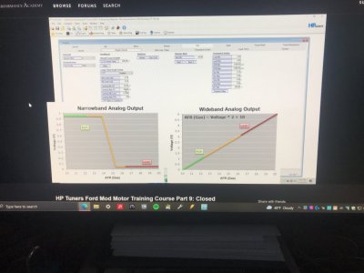

I didn't realize this until I saw a HPTuners video yesterday demonstrating that you can use VCM Scanner software to build a "dyno graph" in it to calc HP using the engine RPM's & engine actual TQ output channels in a user-defined maths graph inputting the HP equation [(RPM x TQ)\5252*DL%] then putting it in the same chart layout group that the TQ channel is displayed in so both will track along w\ each other at the same time.
This will be good to use when doing driving hi load datalogging (including WOT) to give an indication of the ballpark max HP\TQ engine output w\o actually being on a dyno. Done right, you will see the actual 5252 line intersection cross then can find peak HP & TQ output using the chart mouse line. This data will have the advantage of incorporating all actual environmental effects & car body air drag coeff at the time of use into the actual numbers as at a real drag strip, outside of lane\track prep.
So, I won't need a dyno to do my OL tuning as long as I can find a long enough stretch of straight, smooth, level & highly remote roadway at the NAPI International Speedway facilities (will have to work out the times when the facilities are optimum for use).
Good to know......................

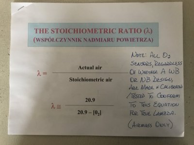

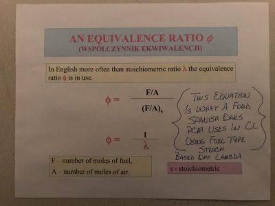

Here is some stuff I found that really closed the issue for me concerning the fuel stoich AFR use in SO PCM calcs, NB O2 sensor usage & the relationship as to what is really going on when a WB O2 sensor is used in OL instead of the NB O2 sensors in CL to calibrate MAF\LWFM tables to then see that as long as a WB O2 sensor was used to calibrate the MAF\LWFM tables, the MAF\LWFM tables are calibrated to true reference airmass, regardless of what fuel stoich AFR is being displayed on the WB controller's display (this is only for a tuner that can't understand fueling in true Lambda lingo but can understand the same true Lambda when it is referenced to a particular fuel stoich AFR that a tuner does understand.....then used w\ the EQ Ratio formula which will reference the known fuel stoich AFR back to true Lambda lingo.....why the EQ Ratio formula is referenced as the English version of Lambda).......note all O2 sensors, whether NB or WB design, use reference air (O2% in air......the ideal 79% N2\21% O2 air reference composition model) to then use to detect the amount of exhaust O2 that differs from the reference air.........just as a MAF sensor uses a hot wire to detect the amount of same reference air that flows across it to rep the total amount of air that is flowing thru the MAF meter housing......thus a true air front end to true air back end measurement methodology so all that was needed is to correct the fuel stoich AFR in tune file to the actual fuel being burned in engine for the entire model to become corrected to true reference air......thus Lambda.
PS edit--From this I can now understand how 1 could make the mistake of leaving the fuel stoich AFR in the tune @ 14.64 (but using E10 @ 14.13) due to the WB O2 sensor controller display set to show 14.64 as "Lambda"...........but WB O2 sensors are calibrated to reference air w\o any fuel in the equation.

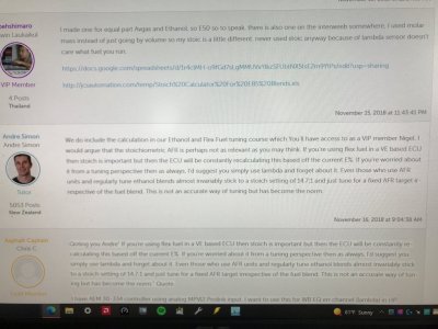

Here is a snippet off HP Academy's forums of head tuner Andre Simon validating all what I just learned\said in the last sentence of this posting he made concerning the topic "Calculate Fuel Stoich Ratio":
From my experiences, he is spot on. During training episodes, Jeffery Evans @ Evans Performance Academy stresses this very forcefully to always set the fuel stoich AFR in tune to match the actual fuel stoich AFR of the fuel the engine is going to burn to correct the PCM calcs & prefers to use a WB O2 sensor & do all calibrating\tuning in OL before switching into CL to then do any further checks to fueling to ensure all is correct to get away from the potential errors that can come from using the NB O2 sensors in CL to calibrate the MAF\LWFM tables.....especially if the mistake is made of not setting the fuel stoich AFR in tune to match the actual fuel stoich AFR of the actual fuel being burned in engine (you're baking in fueling errors into the airmass modeling from mismatched fuel stoich AFR's). The current use of ethanol in unleaded gas in various % of blending makes this an issue for tune accuracy.......especially when emissions is the concern (just demonstrated this earlier w\ my car's engine), but this can also affect engine power output as well.
Where I was fortunate w\ my scenario is that my last tuner actually did use a WB in OL to calibrate\tune\check all in OL (no NB O2 sensor use) 1st so all was actually done to true Lambda SR regardless of what the WB controller display showed (was showing fuel stoich AFR of 14.64 matching the 14.64 fuel stoich AFR set in tune file....I saw it myself during last tuning session.....even though I'm actually using E10\91 oct fuel in car......didn't register at that time but after going thru all the data I posted in prior posting the light bulb came on very bright) which in CL operations will be off (using NB O2 sensors which follow the EQ Ratio Lambda formula which needs the fuel stoich AFR in tune to match the actual fuel stoich AFR in gas tank for any STFT+LTFT corrections\adjustments to be valid or accurate & match any tuning done off the WB O2 sensor in OL). So, all I had to do in tune to fix this is simply change the fuel stoich AFR in tune file to match the actual fuel in tank so now all PCM calcs for anything in PCM strategy is correct in all tuning across the board (CL & OL)......as long as the fuel injector data in tune file is good & accurate & not "scrubbed" (what most tuners do to fix this fuel stoich AFR mismatch depending on severity of differences.....they alter the injector hi\lo slope values to "match this up" instead of just inputting the correct fuel stoich AFR for the fuel). I have my injector's data sheet in hand & I checked this data in my tune file against it to see if it had been "scrubbed".......saw it was all clean (unaltered from data sheet) thus the easy fix.
Otherwise, I would've had to retune engine from scratch to clean the tune up.
This is an example of what I mean by tune refinement...........that prior tuner should have done as this is Tuning 101 type stuff, not advanced type stuff.

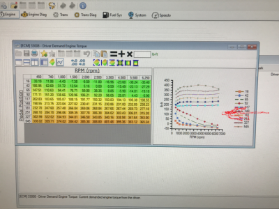

Picture below...........
Getting there......................

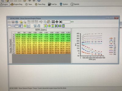

After last posting I went back to "school" to learn how the TQ Management\DD TQ Request mapping (maps the driver controls thru the APP) relates to the TQ Model\TQ Calculation\Engine TQ & Inverse mapping (the mapping the PCM uses to calc the engine TQ output off MAF airload calcs then commands the ETC control to apply desired MAF airload calc'd from TB TPS angle% to meet the APP DD TQ request w\ these 3V's using the Spanish Oaks PCM strategies. Now I know why the void exists in the APP DD TQ request mapping so this is normal (APP DD TQ request mapping axis runs counter to the PCM Engine TQ & Inverse load% mapping so the APP DD TQ mapping doesn't override the PCM Engine TQ\Inverse TQ load% mapping......when APP DD TQ request has APP A\D counts held constant the request TQ trends down (less TQ request) vs engine TQ\Inverse load% mapping trends up (more TQ output) so when the APP DD TQ request crosses lower than matching PCM engine TQ\Inverse load% output, the PCM then knows to stop acknowledging the APP DD TQ request & only adjust PCM engine TQ\Inverse load% output to maintain the APP DD TQ request crosspoint until the APP A\D counts change to change the APP DD TQ request to PCM TQ modeling\TQ Mangement.
Some tuners (my prior tuner & previous BAMA tuners as well did this) will leave the APP DD TQ request mapping between 16 A\D counts to 92 A\D counts (APP 2% to 9% range) alone (so stays stock) as this part of the DD mapping can be very tedious\time consuming to tune\line up correctly to get any extra low RPM TQ response improvement (small in the grand scheme of things but aids in initial TQ increase response resolution if done right) w\o throwing the relationship out of whack causing control issues (IPC Wheel TQ errors) but will tune the APP DD 117 A\D counts to 545 A\D counts mapping (APP 11% thru 53%....53% corresponds to WOT--matches the ETC\Pedal\Pedal Pos to WOT End setting of 545 A\D counts.....when PCM will have already transitioned from CL Normal to OL DD\WOT operation....why some tuners lower the ETC\Pedal\Pedal Pos to WOT Start setting down very low....in the 150-250 A\D counts range....APP 15% to 24% from the stock setting of 460 A\D counts--APP 45%--to tell PCM to start CL to OL transition early off APP counts that exceed the WOT Start setting) to closely parallel w\ the PCM engine TQ\Inverse load% mapping so engine TQ output won't drop due to a mapping cross point but matches w\ the APP DD TQ request so PCM will be trying to maintain mid\high range TQ load% output as high as the spark, VCT, MAF airload% & fueling can get it w\o knock & NB O2 sensor operation skewing the fueling (disabled in OL) to increase\maintain RPM's under high load (flatten out the TQ curve) to drive HP output up (what you saw in the DD map picture I posted in prior post). This is why I was feeling the momentary TQ rate off APP DD TQ request change soften then come on like a surge when the APP was at a certain A\D count point in pedal travel. You can still cause ETC control issues (IPC Wheel TQ errors) if you're not careful here as you'd be cutting a fine line between being a hero & causing ETC runaway (why some tuners won't touch any of the TQ management maps, ETC TB PTA\EA mapping or PCM engine TQ\Inverse load% mapping, especially if engine is still NA, cause most folks install engine components that don't require all this mapping to be touched for the engine to run Ok.....most cams that folks install are of the "full VCT-compatible", "NSR" or "full drop in" variety which means that they are ground\designed to run Ok on the stock tune but not optimized so only some spark, VCT or fueling adjustments are made along w\ massaging this APP DD TQ request mapping to get the HP\TQ increase most get....or they'll make adjustments to the TQ modeling, TQ management, APP DD TQ request mapping as well as ETC TB tuning then raise the IPC Wheel TQ Error max setting from the stock 25,000 to a high enough setting so the PCM won't go into Limp Mode off excessive high IPC Wheel TQ error generation (this is where a ETC runaway can occur from shoddy tuning of the TQ tables\ETC control causing potential loss of control of the car.....is also what I found done in my car's tune & is part of why I decided to start doing tuning on my own car myself going forward so I know what's what at any\all times w\ my car's tuning).
You have to make several parts of the tune file to work in order, at somewhat precise timing during transition from CL Normal to OL DD\WOT seamlessly w\o causing lean spikes, high IPC Wheel TQ errors, etc from poor timing during PCM transition (getting into OL from CL too early or too late)......like a conductor leading an orchestra of several separate instruments to play a song in unison w\o missing a beat or note.
When FI is involved, you have no choice but to work all of this.......is just 1 of the items that can make\break a 3V SO tuner's reputation (takes a lot of patience, knowledge & willingness to put the time & effort in to getting all this TQ tuning\ETC TB tuning optimized & correct in tune so PCM operates happy w\o high IPC Wheel TQ Error generation but get all there is to get & do it safely to boot whether in NA or FI config.......most OEM Ford SO PCM strategies outside of the 07-10 GT500's & any boutique operators like Roush & Saleen, were never written w\ FI operation in mind....only NA but can still be screwed up fairly easily).
Since learning all this I have been spending several late nights going thru several OEM tune files (OEM 2005 GT 300\320 auto trans, OEM 2008 Bullitt 315\325 manual trans, OEM 2009 GT 300\320 manual trans, OEM 2010 GT 319\329 manual trans & OEM 2010 GT500 540\510 manual trans) looking at all TQ tuning mapping to then compare to my existing tune file's TQ mapping to then make changes to DD TQ request mapping in APP 16 A\D to 92 A\D counts area as well as applying some smoothing in the APP 117 A\D thru 545 A\D counts area to remove some out of place TQ output requests to clean up the TQ transitions across the map.
Here is a sample of this:
So far, this is the TQ ft-lb change results when compared to the DD TQ request map in earlier posting:

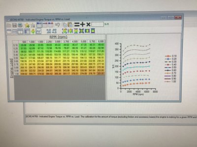

Here is the OEM Engine Indicated TQ Output off load% map for comparison:
Actual testing results coming soon.

After settling into the thought of me being essentially done refining my tune file, my attention turned to the fuel injector reference setting (this sets the injector timing's EOIT--end of injector timing--modeling point to the cam's intake IVO timing point) in my tune file since I've installed Lunati VooDoo #21270700 cams in place of the stock OEM cams. Using the advertised duration-based cam timing points (better match to the cam's 0* timing that VCT uses to determine any cam timing degree change from crank timing) of the stock cams (IVO @ 15* BTDC off camshaft 0*) I find that the 345* crank setting used for injector reference fits (injectors will fire into the back of the intake valves while still closed but right at the point of opening) to promote fuel atomization\swirl into CC off hot intake valves) thus any VCT retard angles from 0* the PCM will use to offset the injector crank angle reference of 345* to maintain this injection to IVO pattern thruout the RPM range.
None of this was covered in the 05-10 Ford Mod Motors HPTuners training videos.........
When I ran my Lunati's thru this same check, I found that for these cams to be realigned to fit the stock injector timing modeling, the injector reference IVO crank angle needs to be set @ 330* in tune (Lunati's IVO @ 30* BTDC off same camshaft 0*), but I find this to be set in my tune file at 349.5* crank angle (4.5* later than stock but also puts the injectors to be firing into already open intake valves--19.5* past the 330* IVO point--instead of firing into the back of closed intake valves at the point of opening as the stock cams were modeled).
This got me to thinking as to what effect on engine performance this is causing.....especially low end TQ, as from all the research I had done suggests that this has the largest effect on low end TQ output & emissions but hardly any effect on mid\high RPM HP\TQ output due to high engine RPM's.
So, I reached out to Jeffery Evans @ Evans Performance Academy to give me some insight into this. Got reply back from Jeffery explaining the traditional reasoning why OEM's (GM, Ford, etc) typically time the injector EOIT to the cam IVO when using port fuel injection (which in general he validated my reasoning of fuel atomization\mixing as to why Ford timed the injector pulses to the cam IVO point) & that is the general pattern to follow but he also stated that the OEM's use other criteria as well (ECT, CC temps, IAT, etc) in determining the final cam IVO crank reference for injector EOIT so to be aware of this to not think this is a set in stone kind of model. But I also noticed in the injector section of the tune file there is a map that references injector timing vs ECT but the map is zeroed out which disables it (also found to be the same in all bone stock tune files as well so HPTuners doesn't provide any access to any of the Ford back end control (opposed to GM HPTuners which gives a lot of access to all this stuff thru GM PCM's) outside of the injector reference IVO crank angle setting & absolutely no mention of any of this in the Ford specific sections of HPTuners forums until 2016 MY when HPTuners provided access to Ford's OVI (open valve injection) algorithm in the later Ford PCM's......which doesn't do us SO PCM folks any good.
So I'm tempted to reset this in my tune file to match up my Lunati's IVO point to the injector's EOIT point mimicing the stock cams modeling to see what comes out of it. I've also looked at some other folks SO tune files that installed aftermarket cams & haven't found any that made corrections from the stock injector reference IVO crank angle setting so all are firing injectors into already open intake valves (all aftermarket 3V camshafts have GI cam advance greater than stock thus cam IVO points are ahead of the stock cams so this is a common issue in the 3V tuning world).
Maybe there's a good reason for not correcting the injector reference IVO modeling to match the OEM modeling purpose w\ these 3V's but I can't find ANY Ford tuner that has given any info on why not to correct this to match. My car runs good w\ these Lunati VooDoo cams having the intake valves already open when the injectors start injecting fuel into CC's, the cat CE ratio results are looking fantastic & I don't get any raw fuel smell from exhaust due to excess fuel scavenged thru CC into exhaust during OL, so it appears that there isn't any operational issues from it but I'll always be curious as to the effects of low end TQ gain\loss unless I test it.........Ford had a reason why.
I even looked at an OEM tune file from a 2007 Ford Sport Track truck (4.6L 3V iron block w\ VCT) that has this injector EOIT reference IVO crank angle setting set @ 360* or TDC or cam IVO @ 0* (don't have any info on cam profile used) so not all 4.6L 3V engines were set up the same even though all used port fuel injection w\ CMCV's & VCT for EGR as well.
Interesting issue & discussion but in the meantime, I'll leave all this as set until I get my Pro Link & WB controller installed as there doesn't appear to be any issues from an operational standpoint from the injectors injecting fuel into CC's thru open intake valves........
