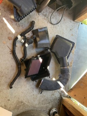

Hey GlassTop09. Is this basically what you have found for your air cleaner install. Not shown is the molded plastic part that is in the core support. It seals the left side of the radiator and provides a connection for the short inlet duct.
Yes Midlife Crises, I have all those parts in hand except the sound tube (wasn't looking for that). I'll get w\ my local Ford dealership to see about that molded plastic part's availability as well as the reservoir engine mounting bracket......... This area on left side of core support by radiator of my '09 is open so just may accept this part. Already got a random VIN# off a '10 GT in hand.
Good to see that K&N does make a panel filter for it.........
PS--I looked again at your picture of the inlet duct......you wouldn't be referring to the plastic part that snaps onto the end of it? If so, the inlet duct I have has this part still attached to it (I noticed that this part isn't on yours in picture). The end of the duct is formed to fit the contours of the left side of the radiator.
Thanks for the info!
:beer:

Yes, you are correct. The plastic part snaps onto the shot duct and “form fits” the space along side the radiator. It goes in from the front and uses a push pin to hold it in place. The duct snaps in from the rear. Sounds like you have all the parts. Have fun.
