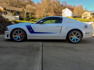

RMB427R
Apr 26, 2009
16
Finleyville, PA
Well, here is a pic of my FR1's. The clearance is the same as the stock. I do have to admit that I'm not completely satisfied with the thin sidewall on the rears. Something that I need to get used to.
Is that what you guys were talking about with the offset and all?
