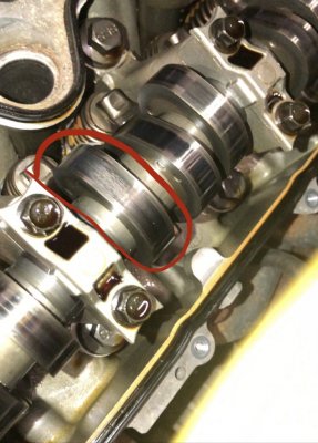

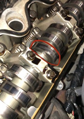

Were the cam lobe running surfaces free of any pitting, just normal contact witness marks? I couldn't quite tell in the video (~17 to 20-ish second portion of the video.)

The first image is at 19sec second is at 21sec, I felt those lobes when I had the chance and they felt completely smooth.

You still have not removed a cam bearing cap. While that lobe does not.look great, it isnt that bad IMO.

If the cam lobes/journals/caps feel smooth without any scoring, there's no cause for concern there. If the cam followers and lash adjusters look fine, the metal flakes could have come from the timing cover.
A bad timing chain tensioner could allow the chain to slap against the cover so you might want to rule that out.
