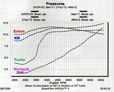

I don't know by what mechanism turbos are easier on the engine but I'll make an analysis. What I do know is that the tendency of stock connecting rods to bend or break correlates with cylinder pressure. Unlike a supercharger, a turbo doesn't place any additional load on the front of the crankshaft so it's possible the reduced level of harmonic vibration also reduces the possibility of rod-breaking spikes in cylinder pressure, thereby allowing the rods to tolerate more torque.

From a point of science, you're absolutely correct as a turbo doesn't require any force from the crankshaft to operate. Centri's or PD blowers require crankshaft TQ to spin up thus the total engine TQ force output required to make the net engine TQ output you see on a dyno is much higher thus is putting more harmonic stress on the entire rotating assembly than a turbo will at the same rated engine TQ output from a centri or PD blower. The connecting rods are usually the 1st part to fail simply due to design criteria........the last part you want to be failing under these harmonic loads is the crankshaft.......the potential damage area for shrapnel dispersion is a lot greater........less folks will live to tell you about it.

Your analysis is correct. A turbo will not need to output the type of cyl pressures (thus boost pressures) needed to make the same net HP\TQ that is required from a centri (not as bad as a PD blower until you hit the upper top end) or PD blower (by far the hardest on an engine due to its ability to hit max boost pressures at low RPM's). This is what is reducing the harmonic stress loads on the rotating assembly.......also why it's more important to optimize the TQ leveraging thru the crankshaft......you'll need less cyl pressure as well to output the same amount of TQ twisting forces. All this is application of physics where it matters the most.
Far too many folks rely on cyl pressure w\ displacement (old school thinking based off fixed cam in block designs) to make engine HP\TQ but don't think to optimize simple leverage where it exists. This is where VCT comes into play & TQ leveraging works whether NA or FI, whether at low or high RPM's.
