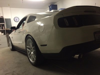

I finally got the MT 275/35/20 and 305/35/20 tires mounted on my Shelby CS66 wheels, 45mm offset and Steeda ultralight springs. A little concerned about the rears, I measure about 1/8" outside the body edge. After some time now has anyone had any rubbing issues?

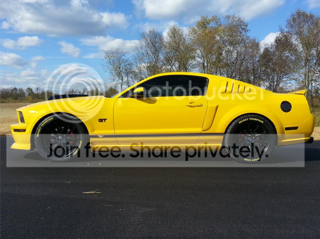

There is another member on here that is running the same size M/T tires and his is a Bright Yellow Mustang.
I don't recall which wheels he is running though.
attachment.php
I just went and found the other member for you.

http://www.s197forum.com/forum/showpost.php?p=2111569&postcount=122

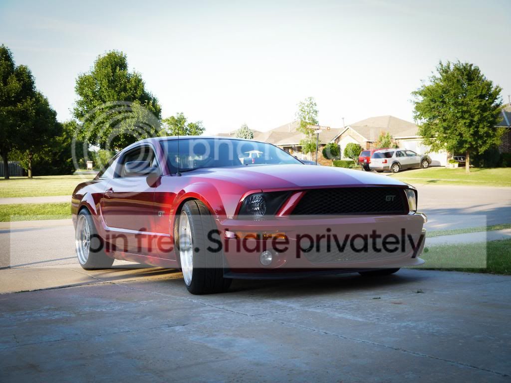

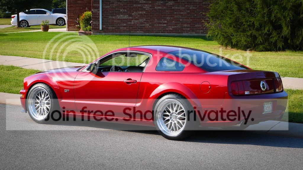

I went ahead and did the 305/35-20 square. The front has a small spacer. I may remove it, just have not decided since it was dark when I fished. Took the car for a spin.....scary. These tires are slippery as shit hope they get better.
