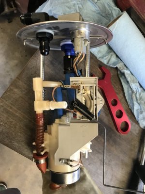

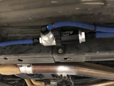

Return fuel system is functioning perfectly, rock solid fuel pressure with a much smaller pressure drop when I hit the nitrous. The rewire at the FPDM was simple since I already have the S&H wiring upgrade.
Adding the return line was the most time consuming part of it since I had to pull the pump and modify the hat for the -6AN fitting. Works perfectly.

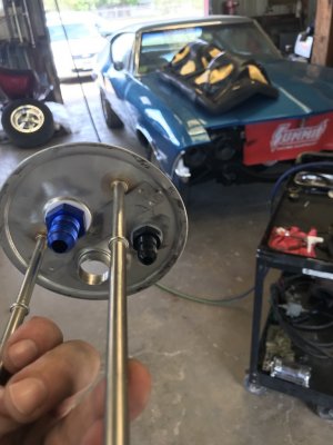

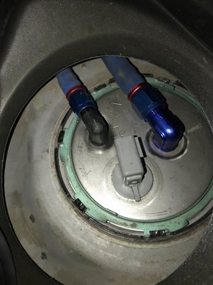

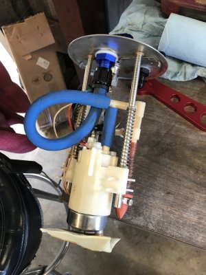

o2f74uWMTnam8xNdMjD4bQ.jpg ms4jxHh0RNqlSNTAkB8jhw.jpg raD%DWY3QB6XV6HhmUpeCA.jpg pSkt9BUyS3Sc0GIP3hiSXg.jpg I decided to upgrade to a Walbro 450 pump and ditch the factory fuel pick up for an -8AN fitting so there was no adapter to worry about leaking. I had issues with the fittings leaking at so I went back and added teflon washers that are not pictured in the last photo.

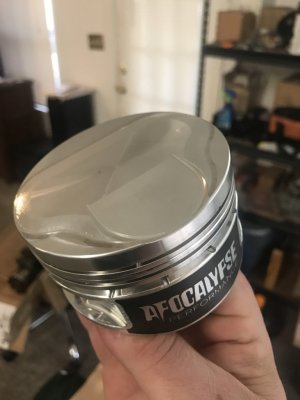

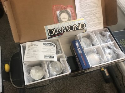

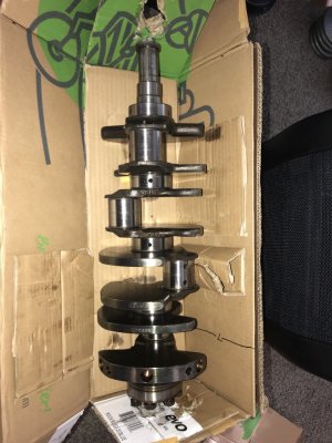

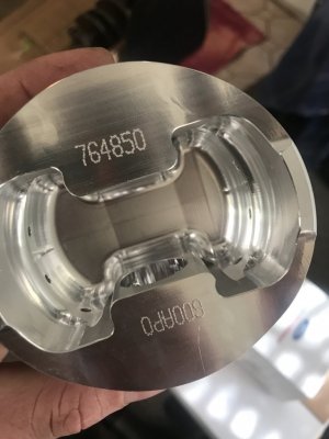

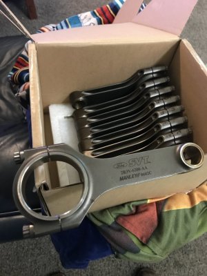

I've finally finished collecting parts to build my spare short block, now to have the machine work done so I can get the new combo together before spring. I have till April to send my converter back for the free re-stall FTI offers for the first year of ownership so my plan is to be doing testing before that deadline.
56530477995__0819CB96-1249-483F-8485-8AF5C03DF2E5.JPG ZLKpEJ1iRCekhXteeVE7Eg.jpg 68E0G2ItQ3+p2r+g3jlOLg.jpg BQEXjMhFSRaPPRUZOikrUg.jpg 2x80fwWgR+ia3qa4VAwzvg.jpg

I've had it back out of the tank after a couple of months of use with zero issues. It is Aeroquip pushloc stuff

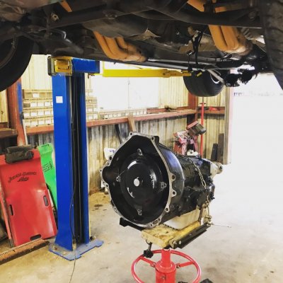

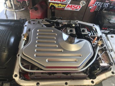

My Lentech auto valve body with a transbrake finally came in. It's installed and working great! Now to work out launching with the TB and nitrous
