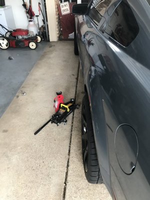

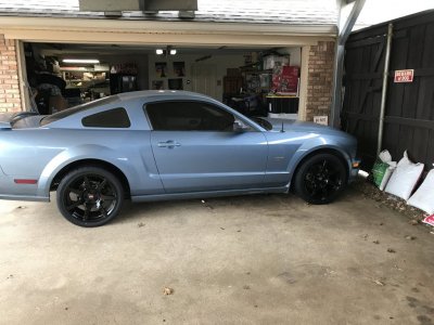

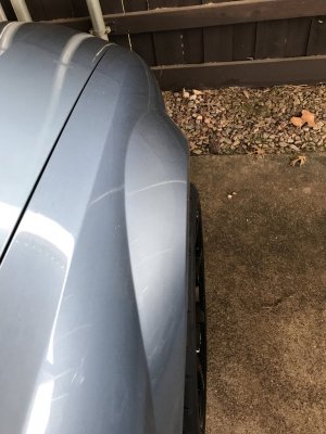

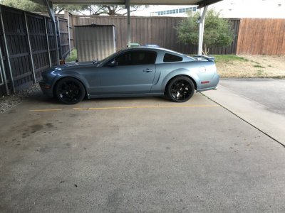

So bought the r350 flow formed rims from lmr and I’m impressed. They got the measurements spot on for offset etc. look at this fitment. I’m on stock suspension and I have 0 rubbing so far.
