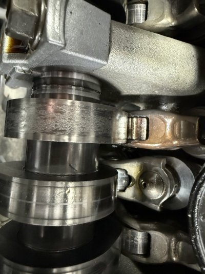

tnythetigr
Sep 25, 2011
15
Found the culprit… assuming I’ll need to swap the cam given the scoaring?IMG_1797.jpeg
