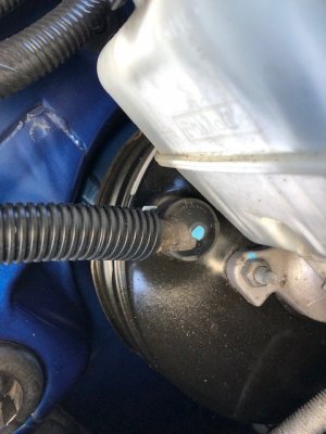

    Looking things over and over, what does your connection at the brake booster look like? Are they all this way? Looks glued or something?

    That's not right... Someone broke it and then smeared silicon or something on it. There's a possible vacuum leak for sure. Below are pictures of a brand new one from an auto parts store. [​IMG][​IMG]

    Ok, good! Ill get that replaced asap!! Thanks. I was hoping some others would snap a pic of what their car has there too!
    Just called napa, they cant even get that plastic part

    Go to your Ford dealership & order that part. Costs around 10-12 bucks when I ordered mine. Only place you can get this w\o having to buy the entire BB assembly..................

    ok, will do! What did your car do with a broken valve? My brakes work great, so Im not convinced this is the fix all find yet....

    Found a vacuum leak in it thru running a smoke leak test back in 1-20 (someone put something hot against it & burnt a VERY small hole in it....was like that when I bought the car but wasn't noticeable until I ran smoke test).
    Ford part# XW4Z-2365-AA

    I broke my vacuum check valve installing the engine, lol. Its a simple one way valve, so any brake checkvalve will work as long as it has the same diameter connections.
