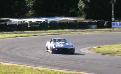

Brakes: What car were you running the PFC83's on??? That is a SERIOUS compound, designed around high initial bite and VERY high temps for high-grip downforce cars. If you had that on a small saloon or a hot hatch, ;-)
The car was a Vintage Road Racer. A 1970 Big Block Corvette Roadster, that was a correct "Schedule K Historic"
It only weighed 1170kg [2574 lbs] and had a ton of torque from a 482" engine.
In NZ we have a track called "Pukekohe" that had a long straightaway that turned into a hairpin corner.
We'd crank the ol'girl up to a calibrated 276kph [approx. 170mph] and brake at 190 metres for a 70kph corner.
The '83 pads really were a necessity for that place
It wasn't the place to practice late braking manoeuvres.
Unfortunately the Aussie V8 Supercars wanted to race on that track ,so they added a chicane [at the 190m mark] to slow down the terminal speeds.
A real shame because a lot of history was lost.
attached is a couple of photos of my "mistress" [ you know , those high maintenance things that only give you a few moments of pleasure :Big Laugh: ]
VERY sexy, nice curves!! "Here's to wives, and here's to mistresses. May they never meet!"
