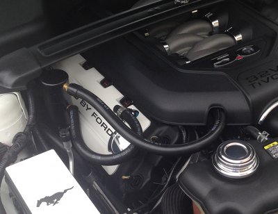

Bob's here too with the longer hoses. It works good...
