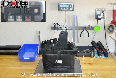

Looking for some feedback from guys using an Odyssey PC680 battery. I have one in my low-tech/carbureted kit car (408cid/10.5:1 compression ratio), and it's been great for six full years now. Of course, that car has very few electrical loads, and draws absolutely zero current when shut off. A modern Mustang is a different story electrically speaking...
I'd like to replace the full size NAPA battery in my '06 GT with the PC680 to save weight. Good idea? Bad idea? Discuss.....

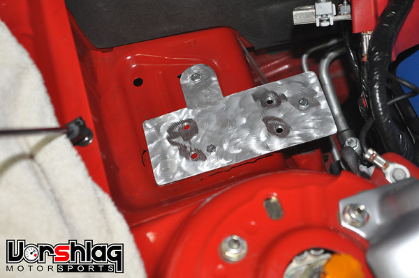

Yes. It is all shown step-by-step here: http://vorshlag.smugmug.com/Projects/S197-Mustang-race-battery/
First I removed the stock fiberglass/composite battery tray, then made this "adapter bracket" out of aluminum. This bracket bolted to the factory battery tray mounting holes + added more holes for another bracket...

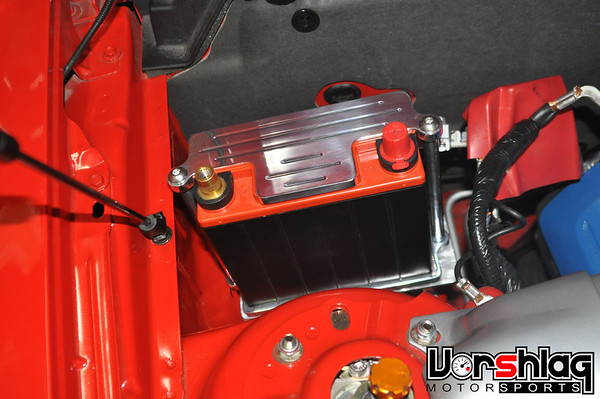

Then I used this store-bought bracket made for a PC680 (West Coast Batteries HDB 680) and bolted it to the "adapter" bracket I made (above step). This used counter sunk bolts to flush mount the store bought bottom to my adapter bracket...
The adapter bracket I made kind of hung out in space so I made this support stand to bolt to the lower factory mounting hole...
This extra "stand" gave my adapter bracket 3 bolt holes to mount too (it is bolted under the 3rd hole, at the right, in the below pic)...
Then the store-bought bracket bolted in place...
Then the battery went in place....
Then the CNC top bracket bolted to the base assembly....
Viola!
I made this all with a band saw, drill, and a welder. Kind of ghetto but it is rock solid and has withstood years of abuse, plus I didn't have to drill a single hole into the car and it fit with the factory positive and negative cables. I can unbolt all of this and reinstall the stock bits in 5 minutes.
