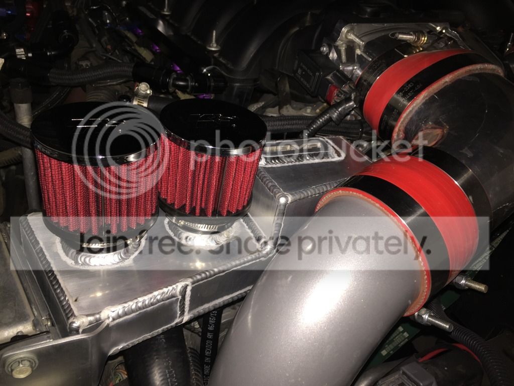

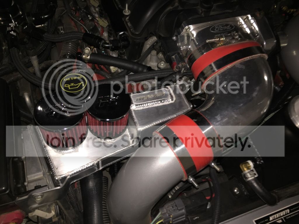

After tying a few different brands than didn't work for my needs. I had a local speed shop build me a custom one.
