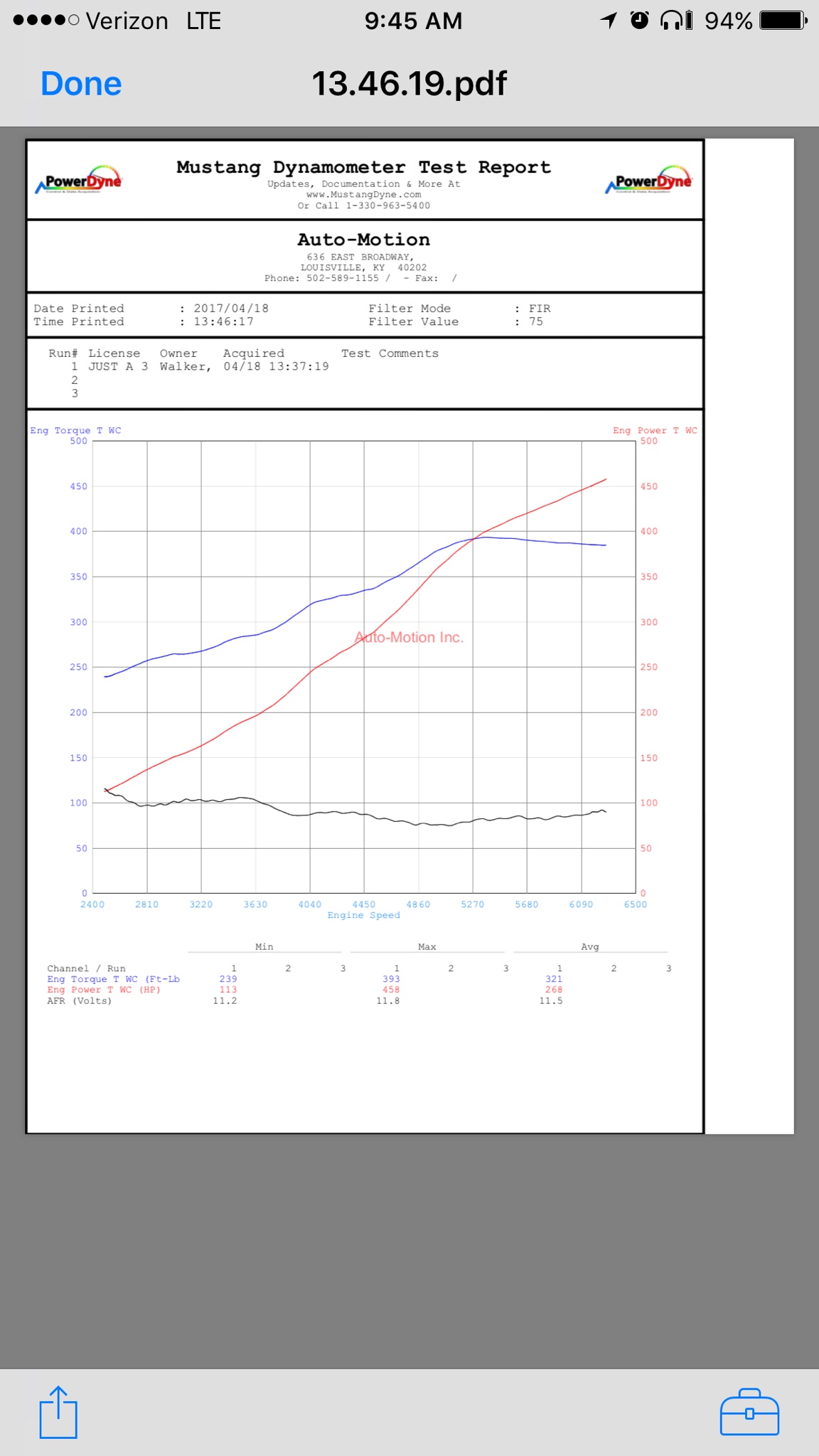

i don't have a picture of the run with the 67mm but here is my final run on wastegate pressure and the 70mm. When I get home I'll snap a picture so you can see the difference the ball bearings and slightly smaller compressor wheel make.

Id love to see the comparison, the 70mm put up some good numbers.

My only complain with the 70 is the spool time. I also recommend when budget permits to buy a better wastegate. Mine sticks a little before it starts to dump properly. In the latest dyno graph you can see the torque dip a little when it does it.
