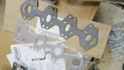

I got oem ford gaskets yesterday and they seem thinner and less rigid than the ones that came with the headers. They are thin black fiberous material on both sides with a very thin metal core.... Are these indeed oem gaskets and what I should use? I ask because I ordered from ebay so want to make sure they are legit.

3. If those are the Ford gaskets at the top in that pic you posted, then that is correct. Most of these newer gaskets are what they call multi-layer steel meaning they have a couple layers of very thin steel and a couple layers of a paper-like material. They should be fine.

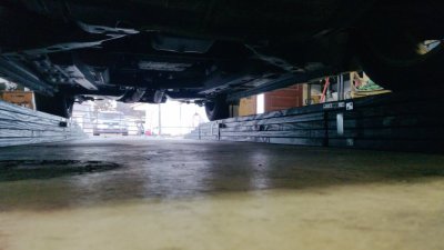

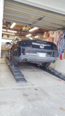

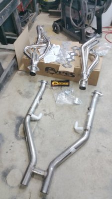

Got her on ramps but will have to wait a bit to get started.... I fell sick as f####. Dont mind the dirty ass car... Hasnt been washed in months lol
So the h-pipe just came with the single u-bolt clamp and the single band clamp. Not sure which is supposed to be used for the H union and which style for the downpipes.
i just ordered 4 of the accuseal clamps
I plan to just use bolts for headers. Are supplied bolts good enough? And just get them as tight as i can?

What kind of bolts did the Pypes come with? Are they the flanged-head header bolts?
Also, you might not want the Accuseal style clamps anywhere except the H crossover. They seal best on a pipe with relief cuts in it. For the headers-H pipe you want lap joint band clamps, and for the H pipe to over axle you want butt joint band clamps (if you don't still have your factory ones, mine were a rusty mess)

They are flanged bolts, not sure what grade... Cant remember if they were marked or not and am at work.
Damnit... I ordered 4 of the accuseals lol. I seen those lap joint clamps and almost ordered 2 but in my mind i didnt see what the half of the clamp did that was on the smaller diameter side other than keep the whole thing from sliding off but as long as the clamp is tight enough that shouldnt be a problem. I may order some or might just buy a roll of stainless wire and weld it all once its in and fitted

I wouldn't weld it together, what if you need to disassemble it somewhere down the road?
The butt joint clamps can be had pretty cheap. Look up Walker 33240 for the 2.5 butt joint where the H pipe connects to the over axle pipes. They're $8 each on RockAuto. These are walker Mega Clamps, they work pretty well. Can also try Torctites, they are a little more but generally seal better. Search "torctite 2.5 butt joint lap band clamp stainless" and you can find those. Only need 2 of these clamps.
Sorry, I may have thrown you off a bit- I keep forgetting you have Pypes and they are flanged. You might need 3 of those 4 clamps anyway, don't the short legs that connect to the headers also attach to the H pipe? If so you can use the accuseal clamps there.
But, you will definitely need butt joint clamps at the end of the H pipe...if you've never had it apart, you probably have the stockers and on mine, they were really hard to remove and definitely not reusable (very rusty).
