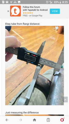

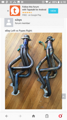

Heres some comparison pics from the thread i dug up about these headers...
Screenshot_Opera_20181220-061855.png Screenshot_Opera_20181218-202551.png Screenshot_Opera_20181218-202558.png
He didnt run that header with 1.6" .... Mines 1.75" with calipers on it :(

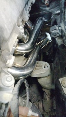

Here's a few pics.
Looking at these...you may be right, I think that one primary tube will give you trouble.

On my JBA ceramic coated LT's.... that offending primary easily clears the steering shaft, and that's with the eng lowered 1/4".... via the steeda eng mounts. With the Pypes version..and eng at stock ride height, he may well have an issue. I believe others have had to .."massage" the offending primary..to gain clearance. Even then, you would want stiffer eng mounts. With oem hydra mounts, the eng will be rocking back and forth a bit.... just enough to smack the steering shaft. But this is on my 2010 GT, so a 05-09 car could easily be a different ballgame, even though both are the same 4.6 L .

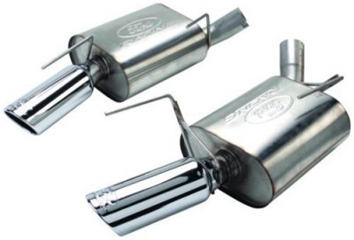

Im pretty sure i read that the steedas were rebranded borlas with a difference in internal batting material in this thread...
https://mustangforums.com/forum/gt-...8-the-official-s197-exhaust-sound-thread.html
Or it was a similar s197 exhaust thread.
I dont know what exactly steeda had done different with there axlebacks but several members swore the 4.6 3v, longtubes,OR H, and the steeda axle backs were one of the best sounding 4.6 exhaust setups and from the couple clips i listened to it sounded mean.
Drone is supposed to be minimal but who knows. Cant really tell from video clips.
All i do know is the more i research the more indecisive i am lmao
Upon further research, it appears the info you acquired from Mustang Forums regarding the Steeda Stingers for the 2010 Mustang is, in fact, a rebranded Borla with different internal baffling. What I don't quite understand, however, is the reason they're only produced for the 2010 models and not for the 2005-09 cars? Doesn't make much sense IMO, but it is, what it is lol. Anyhow you may want to check with Steeda tech support prior to making a purchase just to make certain as to whether or not you may experience more than just minimal drone by running an off-road exhaust application. IIRC, the Stinger axle backs are designed and engineered to be run with the factory catted H in place in regards to the minimal drone factor that Steeda claims on their website. Otherwise, it may be in your best interest to look into the Borla touring axle back as your best option for minimizing drone when running an off-road/LT header application :shrug:
Not necessarily true. I don't know how long it was made, or if it was made for anything other than the 2010, but my axle back looks exactly like this except with the Ford Racing logo stamped in the case:
https://www.modularheadshop.com/i-2...uring-axle-back-exhaust.html?ref=brand:100871
And it is most definitely 304 stainless as I bought it used and have run it for a couple years, and have not seen a speck of rust on it.

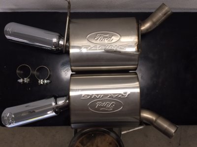

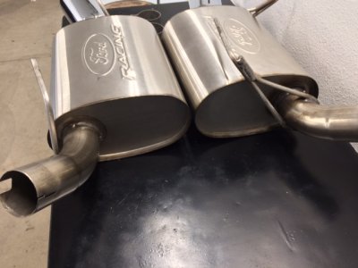

Just to follow up, I finally came across the old Ford Racing part # for the rebranded Borla 11752- 2005-09 mustang gt/gt500 touring axle back exhaust that used to be produced for Ford Racing by Borla. The Ford Racing part # was M-5230-SVT1. I've also included images along with the part number.

So, that's weird. The set I bought did not have the logo-embossed tips and had double wall tips instead of rolled edge, had the hangers attached differently, logos were flipped, and the mufflers were offset/offset instead of offset/center. Again when I bought these the seller said they came off a 2010 but I wonder why so different?
06 T-RED S/C GT
Jan 8, 2016
2,270
370
Carnegie, PA

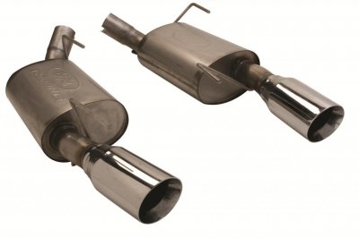

After more digging around, I located your Ford Racing touring axle backs. Summit Racing used to sell them back in the day. Part number M-5230-MSVTC was manufactured exclusively for 2010 Shelby GT500 models for Ford Racing by Borla. Part number M-5230-MGTC was manufactured exclusively for 2010 GT models for Ford Racing by Borla. Therefore the seller who said they came off a 2010 was actually spot on. As for the reason behind the double wall tips instead of rolled edges which Borla is well known for? I suppose will never know the answer lol. I also have no clue as to why they did not include logo-embossed tips either, but it is, what it is. All I can say is that your Ford Racing Touring mufflers are authentic 2010 GT/GT500 rebranded Borlas. Also included are the Summit Racing and e-bay links with images. Anyway, hope you'll find the info provided as useful.
https://www.summitracing.com/parts/fms-m-5230-mgtc
https://www.summitracing.com/parts/fms-m-5230-msvtc
https://www.ebay.com/itm/Ford-Racin...041?_trksid=p2349526.m4383.l4275.c10#viTabs_0

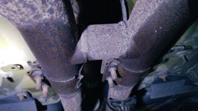

Anyway.... Ive decided to go ahead and proceed and see how bad the steering shaft interferes with these headers. If its not possible to make them work then I will order some actual pypes headers. I thought about jba ceramic but then would need new midpipe too.

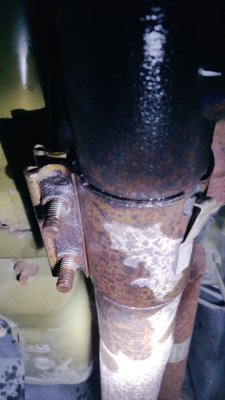

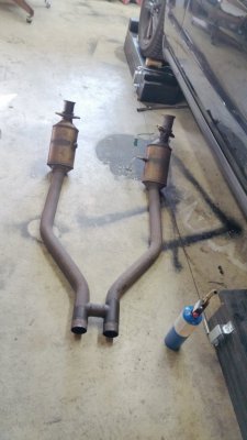

I got battery tray, steering shaft, starter out and all exhaust manifold nuts/studs off, all exhaust nuts off from midpipe forward.
The stock midpipes loose but i cant budge the band clamps that secure the back of the H pipe.
Ive tried to pry on the clamps and tried to beat on them with a hammer lightly... Any pointers to get this midpipe freed?

Spray the studs down with pb blaster or similar and tap them with a hammer. You could even try tapping the clamps from the sides to push it back or forward (as opposed to pushing it up/spinning them to free them) with emphasis on tapping.
deezdrama
Jan 21, 2018
168
central il
This has been the worst roadblock of this whole project. These damn band clamps wont budge.
Nuts came off no problem but they might as well be welded on there with magic unicorn mig wire.
I soaked em last night with pb blaster. Hit em with torch, resoaked, pried on em, beat on em all morning...... Nothing. Bolts wont hammer out, clamp wont pry open, wont slide back...nothing.
Might have to get the grinder with cutoff out. I just dont want to mar up the catbacks cause i plan to reuse them for now. Ford should of really went with stainless.... Hell my crown vics are factory stainless.
I noticed my stock midpipe has no hangers.... Whats up with that?
EDIT........
A last ditch beatdown prevailed lol... Why do i always see peoples stock mids having hangers and this dont?

Wish i had the dough right now to grab those up for my 2010..... So the ford gt500s/tourings are nolonger made?
Im going to go with either the tourings or the steeda branded stingers for the 2010.
With longtubes and catless H which do you guys think would sound better? Ive narrowed it down to those two. I like deep controlled bass loud. I dont mind a little drone just not a ton
The 2010 Ford Racing gt/gt500 tourings went out of production well over 5 years ago, perhaps even longer. At any rate, If you can afford the cash for them listed on e-bay? I'd snag them up before they're gone. Otherwise, go with the Steeda Stingers for $479.95. As mentioned in a previous post, if you're concerned about the drone factor by running an off-road/LT header application? I would go with the 2010 Ford Racing Touring axle back listed on e-bay for $499.99 which are just $20 more over the Steeda Stingers. Anyhow, I went ahead and re-posted the e-bay link for the 2010 Ford Racing Touring axle backs which are currently still available.
https://www.ebay.com/itm/Ford-Racing-M-5230-MGTC-Mustang-GT-Touring-Muffler-Kit/153012771041?_trkparms=aid=111001&algo=REC.SEED&ao=1&asc=20180105095853&meid=028c229db6ad4cf3bfae3fb13648b84e&pid=100903&rk=1&rkt=4&sd=153012771041&itm=153012771041&_trksid=p2509164.c100903.m5276

I went ahead and pressed forward to dryfit the driverside header to see if steering shaft would clear. Not even close! That primary interferes about a whole inch too much and lowering engine looks like it wouldnt help and maybe make it worse.
Wow the header bolts on bottom are about impossible to get to.
So.... Tomorrow going to have to pull driver motor mount and pull header and throw them things in trash or hang em on wall.
Thanks for doing that research! I looked all over the place after buying mine but could not find the exact model anywhere. So, interesting to know it was made for the GT500.

Just to make certain we're both on the same page, your Ford Racing mufflers could be either part number M-5230-MGTC which is made for the 2010 Mustang GT or M-5230-MSVTC made for the 2010 Shelby GT500, but either way, both are pretty much the exact same muffler with the only exception of possibly having different internal baffling for the M-5230-MSVTC 2010 GT500 over the M-5230-MGTC 2010 Mustang GT.
